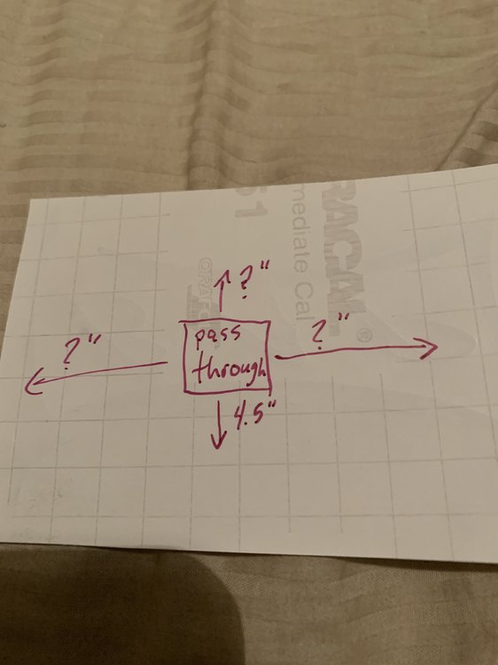

2 minutes ago, 1point21gigawatts said:
So the box is right up against the rear deck lid from the top so there is  1" of gap. As for the sides the box can only be 15" from the center to the sides. But there is 6" inches of space but that part is not level due to the all wheel drive system

Because that would contradict the 30” wide measurement you first gave me. That would mean it is 36” wide. I need to know the exact measurements.

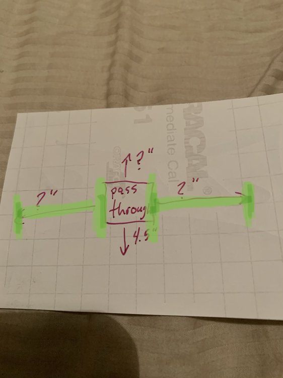

1 minute ago, 1point21gigawatts said:
When I say side measurements, I mean from the exit of the pass through, not the center of the pass through.

And double check and make sure from the trunk floor to that pass through is exactly 4.5”. I need EXACT measurements. A pass through has to be measured EXACT, even to the 32nd, not rounded off.

17 minutes ago, 1point21gigawatts said:
I just need the 2 side measurements. So 15” on each side?
Yeah the 30W is the width of the back seats so 15 on each side. I can do 6" more so 3" each side but the box wont be level as there bumps on the sides for AWD
