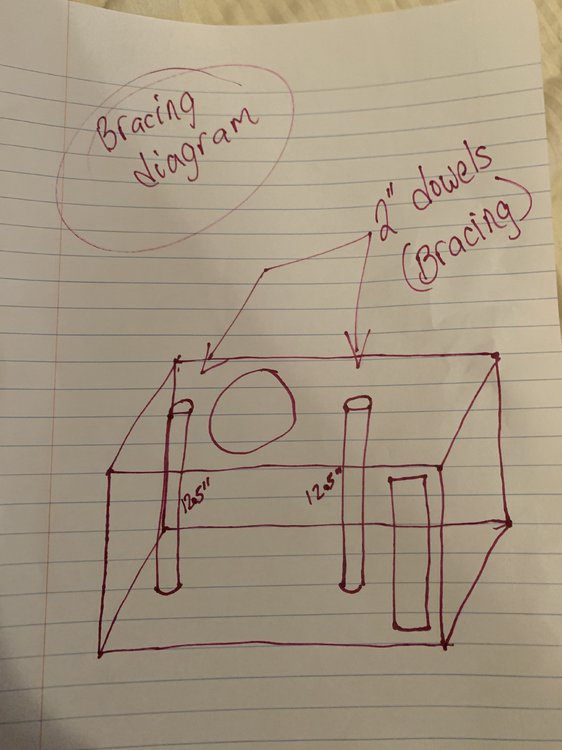

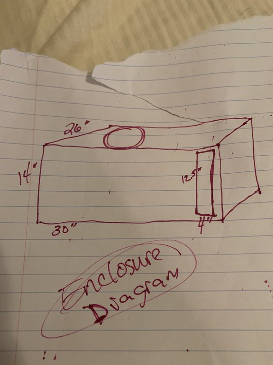

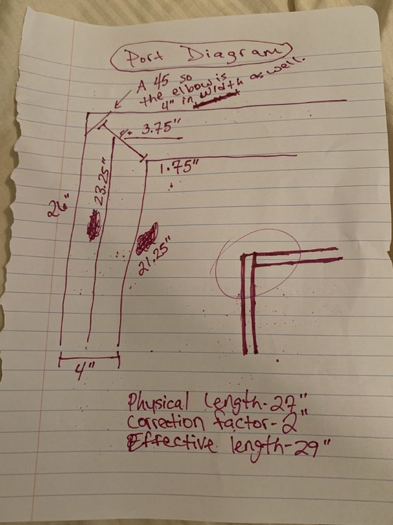

1point21gigawatts Posted July 20, 2020 Report Posted July 20, 2020 “How can we help you?” “And don’t forget to tell them that the customer isn’t always right.”
1point21gigawatts Posted July 20, 2020 Report Posted July 20, 2020 Just send them pictures to the person building your enclosure and they will know what to do. Don’t second guess it or doubt it. Trust me bro. This is what I do. “How can we help you?” “And don’t forget to tell them that the customer isn’t always right.”
