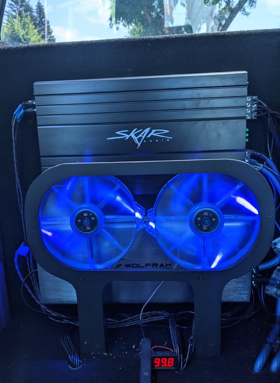

crownvictoria31 Posted July 23, 2020 Author Report Posted July 23, 2020 15 hours ago, fishchris1 said: I love my Wolfram 2400.1. I did overheat it once.... Had gotten a new HU and was getting a little carried away, for too long, on a hot day..... The really bad thing though, was that (I believe... But can't be sure) it confused my head unit, which then started popping up with a message that said, "Amp Error"... Even after the amp cooled all the way off. Litterally had to pull the HU out and disconnect everything (I have no idea what actually fixed the problem) but hooked it all back up, and all was good. I'm just extra paranoid about overheating my amp again. So, I put a thermometer on my amp, plus two 200mm case fans. Only thing is, I have no idea how high the temp can get before it shuts off ??? So, I'm probably kind of a wimp, not letting it go over like 120... When it can probably go to 140... But whatever. It only takes a couple minutes break to cool way down fast with the fans. Your amps are in a open area and it still overheated?
fishchris1 Posted July 24, 2020 Report Posted July 24, 2020 8 hours ago, crownvictoria31 said: Your amps are in a open area and it still overheated? Well yes, but not a lot of air gets back there. Then again my RF power 1000 never overheated.... And that Skar 4 ch definitely gets hotter, than the Wolfram, and it never overheats either. The Wolfram is a solid amp, but yea, it seems to get hot pretty quick. With the fans, and the AC cranked up, I think I can pretty much play it right to clipping almost indefinitely, without overheating, but I know a lot of guys can't give their amps so much open space, and cooling....
