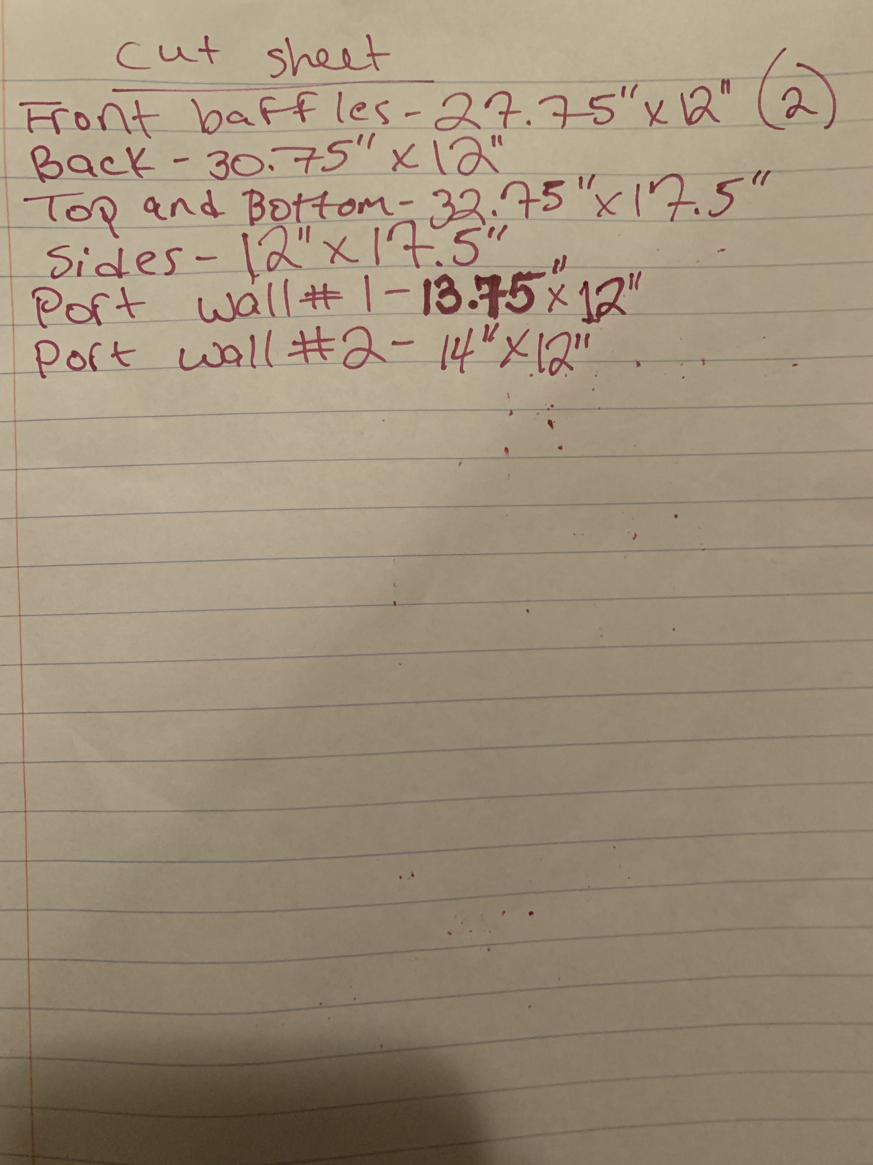

58 minutes ago, 1point21gigawatts said:
hey thanks for that. i appreciate the help.
just a question and then 1 problem:
question:

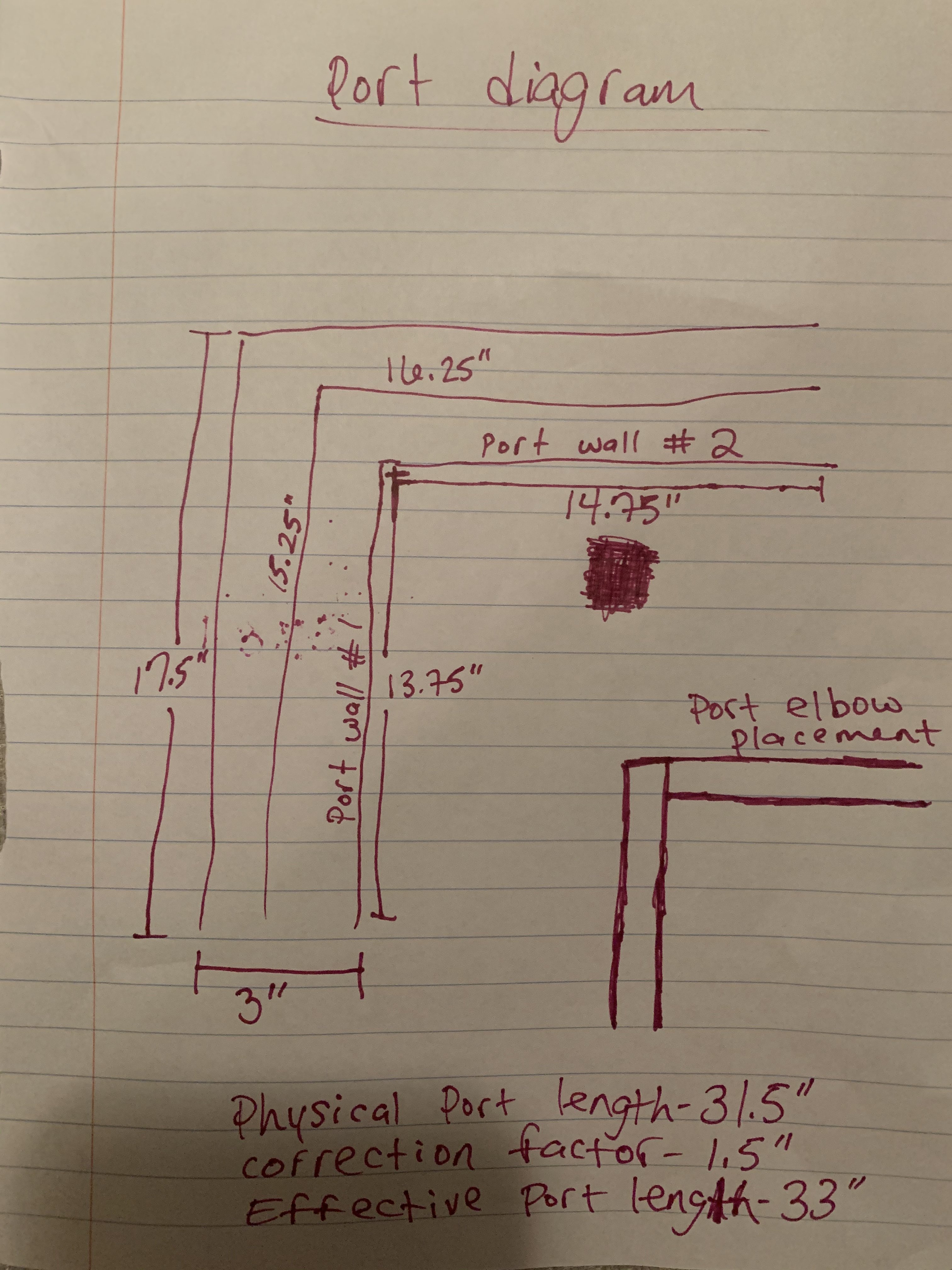

the physical port length is 31.5 but in the first pic you have the port wall side 1 as 13.75 and side 2 as 14 which adds up to 27.75 which is like 3 inches shorter than the 31.5 then in the 2nd diagram the picture shows port wall 1 as 13.75 and port wall 2 as 14.75..
so little confused there.. what should i be cutting the port wall pieces as 13.75 and 14 or 13.75 and 14.75 and how come they dont add up to 31.5?
problem:
remember my max dimensions are 13.5 tall x 32 x 17
to get to 2.3net i pushed the max dimensions a bit more to 13.5 x 32.25 x 17.5..this will be a test and it MAY get stuck or will be very hard to get in and out i will have to router all outer edges to make sure it gets in..however...
your diagram is 13.5 x 32.75 x 17.5   this will prob not work as the width you made .75 more instead of .25..  box will get stuck. i can manage .25 more but .75 is pushing it esp since im going .5 more on the depth.
i know it sounds ridiculous but i am really really pushing it with the extra .25 and .5
oh and what is the final tuning and net airspace and outer dimensions of this box?

And 32.75” was a misprint. I meant to put 32.25”. Lol my bad! All the other cuts measurements I used 32.25” as the width to do my calculations but I accidentally wrote 32.75” instead of 32.25”.

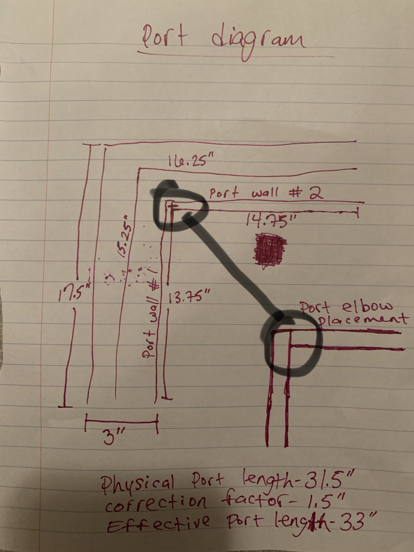

And you would cut that second port piece as 14”, even though that wall is 14.75” because the way the port elbow connects adds an extra .75” to the length. So the piece should be 14” in length but that wall is 14.75” in length.

Thanks for clearing that up. And thanks for the help. I will let u know how this turns out.
I was under the impression that torres uses the physical port length as the actual length of the wood pieces you cut so when you had physical port length written there as 31.5 but the 2 pieces didnt add up to it, i got confused.
Edited by akuma4u
The length of the port is measured down the center of the port, not on the port walls. Add up the middle length. Since the port is 3” in width, the measurement down the middle would add 1.5” on each port wall. So that’s 3”. 13.75”+14.75”=28.5”+(3”)=31.5”. The tuning is 32.76hz and net volume is 2.29 cubic feet after bracing.
