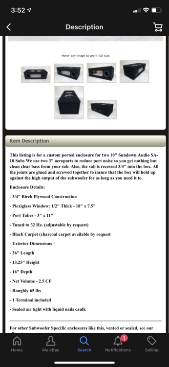

Audiohz Posted July 30, 2020 Author Report Posted July 30, 2020 10 minutes ago, Backwoods said: I didn't know it was a hatchback... I've never owned a hatchback so I can't speak from experience there. In trunks I've had better luck with subs and port firing to the rear, in SUVs I've had better luck with subs up port rear. Impedance rise definitely deceases power... With or without a box, and will do so on smaller or larger amps. But regardless a larger amp will put out more power than a smaller amp. And 5000rms even after rise is a lot on stock electrical, and more than I'd want to use with a prefab enclosure. Anyway if you're totally against a custom enclosure, and you want you subs pointed up... I'd prolly go with the subs up aero port to the rear box... But that box is a bit big for U series 10s. If you wanted your subs firing to the rear, or forward, I'd go with the D4S enclosure. But that box is a little small. Neither is ideal. Take your pick. Here’s what’s strange to me the same box same seller on eBay listing same Dimensions but net volume is lower I’m confused which net volume is correct

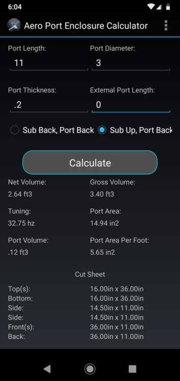

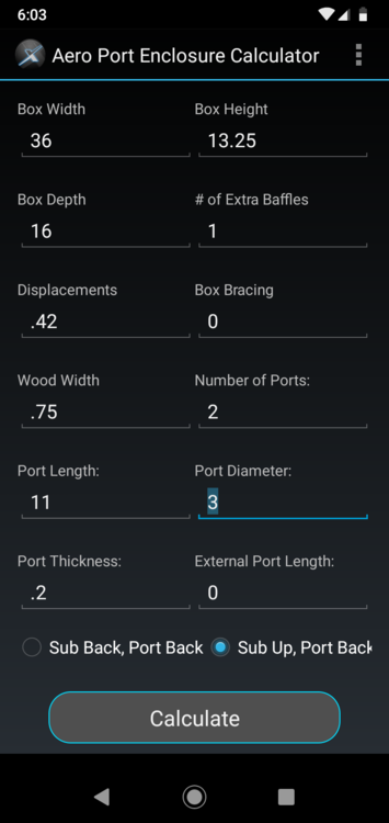

Backwoods Posted July 30, 2020 Report Posted July 30, 2020 Download the app Ultimate car audio, and you can type in all the dimensions and get a close figure of what it really is. I got closer to 3.06 with an extra baffle on top... But with two 3"x11" ports im getting about 30hz before sub displacement is added in. If the app is correct, After sub displacement with 2 U series 10s, the box would be 2.64 net with a tuning of 32.7 Thats still a bit big for the 10s. more than 30% larger than recommended. Singer 250amp Alt, Singer PCM bypass harness Titan8 Lithium Underhood safe BCI PWR-S5 Big 3 W/ dual runs of power/ground. All 1/0awg OFC SounDigital EVO 5K amp, Two 15" Fi SSD subs Next Level Fabrication @ 7 cubes net, tuned to 32HZ
