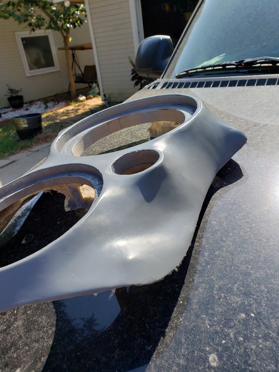

1point21gigawatts Posted October 7, 2020 Report Posted October 7, 2020 Are you going to wrap fabric around that and then staple it and the cut the speaker holes and then fiber glass it, sand it, body fill it, sand it and then prime it, sand it again and the paint and clear coat? “How can we help you?” “And don’t forget to tell them that the customer isn’t always right.”
dog24fret Posted October 7, 2020 Author Report Posted October 7, 2020 36 minutes ago, 1point21gigawatts said: Are you going to wrap fabric around that and then staple it and the cut the speaker holes and then fiber glass it, sand it, body fill it, sand it and then prime it, sand it again and the paint and clear coat? I am going to wrap fabric. Then use fiberglass cloth in top. Then the other stuff minus paint. To be honest I am not sure if I'm going to paint it or vinyl it yet. I got to first see if I have vinyl that would work. The only reason I'm not sure on the painting. I don't want a shiny finish on it. Even the matt finish paints seem to be too shiny to me. If I can get it smooth enough vinyl would be best imo. But this is the first time doing this stuff so jury is out on it. Still learning as I go lol Cowboy Escort GrAnny ThUmper The Burp
1point21gigawatts Posted October 7, 2020 Report Posted October 7, 2020 14 minutes ago, dog24fret said: I am going to wrap fabric. Then use fiberglass cloth in top. Then the other stuff minus paint. To be honest I am not sure if I'm going to paint it or vinyl it yet. I got to first see if I have vinyl that would work. The only reason I'm not sure on the painting. I don't want a shiny finish on it. Even the matt finish paints seem to be too shiny to me. If I can get it smooth enough vinyl would be best imo. But this is the first time doing this stuff so jury is out on it. Still learning as I go lol It’s easier to just vinyl it or carpet after you fiberglass it. No prep work, just sand it and vinyl it or carpet it. That’s what’s up dude. I can’t wait to see it. “How can we help you?” “And don’t forget to tell them that the customer isn’t always right.”

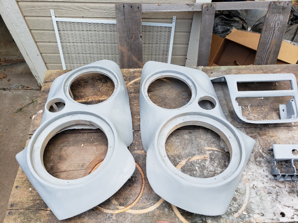

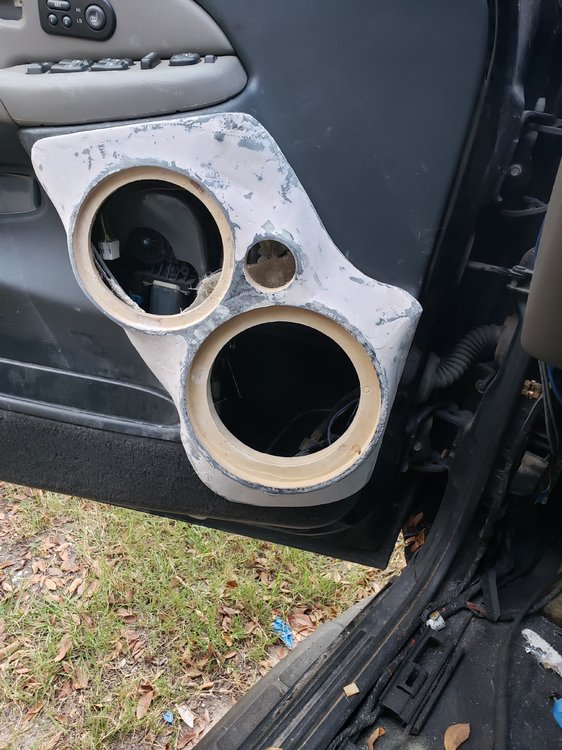

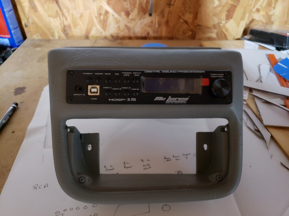

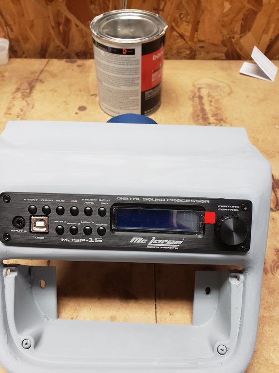

dog24fret Posted October 18, 2020 Author Report Posted October 18, 2020 stock location of cassette player in the center console. Now for the dsp. Onstar was removed for the bass knob.They fit pretty good imo. Little snug at the dash section. Will have just enough room for the vinyl before rubbing.I think they turned out pretty decent for the first time. Still has some minor blemishes. I wanted perfect surface but just couldn't get it right now. I am sick of sanding lol Cowboy Escort GrAnny ThUmper The Burp
1point21gigawatts Posted October 18, 2020 Report Posted October 18, 2020 21 minutes ago, dog24fret said: stock location of cassette player in the center console. Now for the dsp. Onstar was removed for the bass knob.They fit pretty good imo. Little snug at the dash section. Will have just enough room for the vinyl before rubbing.I think they turned out pretty decent for the first time. Still has some minor blemishes. I wanted perfect surface but just couldn't get it right now. I am sick of sanding lol Yo, those are nice. And imperfections aren’t bad because carpet or vinyl fixes that. But honestly, them pods and dsp holder look good. I would finish prepping them and scuff them with fine grit sandpaper and paint them flat black with some trusto rusto spray paint. “How can we help you?” “And don’t forget to tell them that the customer isn’t always right.”
dog24fret Posted October 19, 2020 Author Report Posted October 19, 2020 47 minutes ago, 1point21gigawatts said: Yo, those are nice. And imperfections aren’t bad because carpet or vinyl fixes that. But honestly, them pods and dsp holder look good. I would finish prepping them and scuff them with fine grit sandpaper and paint them flat black with some trusto rusto spray paint. Thank you. The pods will be covered to match the door main color. The dsp and bass knob I might do the black paint. I wanted to repaint the entire center console another color besides that khaki or grey color it is. But we will see lol Cowboy Escort GrAnny ThUmper The Burp
1point21gigawatts Posted October 20, 2020 Report Posted October 20, 2020 23 hours ago, dog24fret said: Thank you. The pods will be covered to match the door main color. The dsp and bass knob I might do the black paint. I wanted to repaint the entire center console another color besides that khaki or grey color it is. But we will see lol Vinyl and fabric paint. From what I see, you would do good with whatever you decided to do. Nice build! “How can we help you?” “And don’t forget to tell them that the customer isn’t always right.”

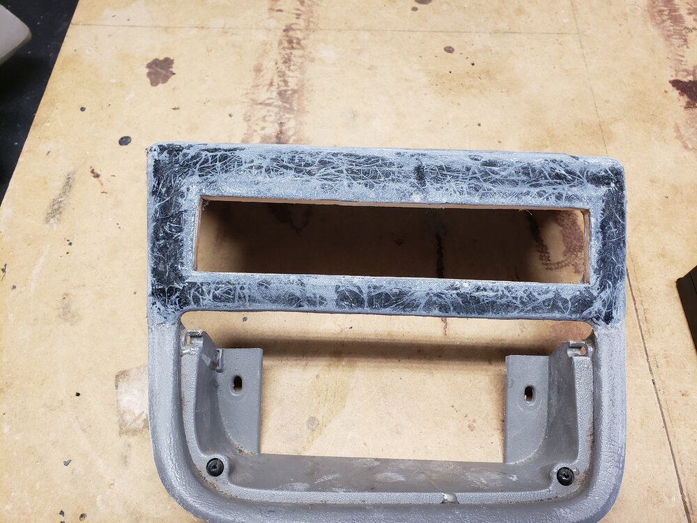

dog24fret Posted October 23, 2020 Author Report Posted October 23, 2020 I think they are ready to be covered now. When the vinyl gets here. Cowboy Escort GrAnny ThUmper The Burp
dog24fret Posted December 14, 2020 Author Report Posted December 14, 2020 Been a spell updating this. Have got more work done. Think this came out pretty decent. Cowboy Escort GrAnny ThUmper The Burp
