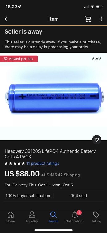

slowfkncar Posted September 27, 2020 Report Posted September 27, 2020 Yeah bro you can shape them into any size you want, as long as you keep it wired in 4s and have enough in parallel to take your charge/discharge current. Im also using headway 38120 (4s24p) in one of my cars and love them, i have three rows of 32 cells that lay flat below my amps, this opened up a shit load of room after removing 2 aged d3100's. I've been wanting to try the prismatic LFP's at batteryspace but im not sure of the quality at that price, the specs are nice for car audio.

slowfkncar Posted September 28, 2020 Report Posted September 28, 2020 1 hour ago, JakeW said: So every 4 would give me 40ah at 12.8v ish.... what is your experience compared to agm? 16 cells of the above in 4s4p would give you 40ah/12.8v (14.6 max) assuming the capacity isn't inflated. I have not had a negative personal experience with lithium yet & I've lost count of how many LFE packs and solar power walls i have built/worked on. For car audio my experience is float voltage is higher and voltage doesn't swing as much, i can demo all the way to 10% without the engine running an my car still starts, obviously if your are trying to pull more then the pack can handle then your going to have bad results.
