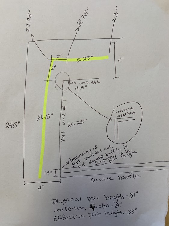

1point21gigawatts Posted October 6, 2020 Report Posted October 6, 2020 Physical port length is the length down the center of the port. That 33” is effective port length which is what the subwoofer actual sees. So to figure the physical length or vise versa, you have to factor in the correction factor, which is half the width, or height if it’s a horizontal port, which is 2” in this case, negate that from the 33” effective length and that equals 31” physical port length. That is a long port, so it will make a bend and to find the actual center measurement, you have to factor in that 2” correction factor twice on the bend since it turns a corner in the middle. The port walls will be smaller than 31 total inches, since there is a bend. “How can we help you?” “And don’t forget to tell them that the customer isn’t always right.”

1point21gigawatts Posted October 6, 2020 Report Posted October 6, 2020 This would be what that port design would be if the port was on the front of the enclosure, not center port, sub back port back, double baffle. “How can we help you?” “And don’t forget to tell them that the customer isn’t always right.”
