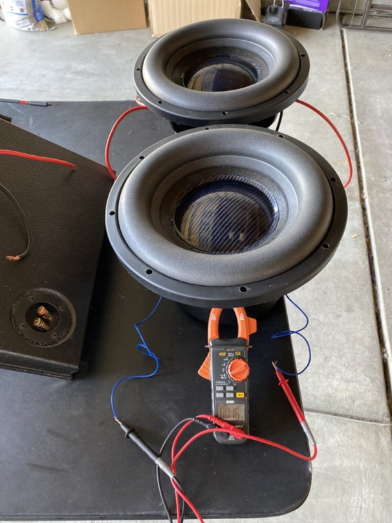

How often do y’all do it to make sure they’re still good? I’ve read different numbers online like -0.5 to +0.5 ohm is good range.... and I’ve also read something like 80% under is good. Of course they “should” ohm under the designated impedance rating....  im just curious y’all’s experience. Dc lvl 4, 1 older from about July, and 1 newer from a few weeks back that I’ve been breaking in. Both are 2ohm DVC. sub #1 coils 2.1 & 2.2, series is 2.8 ohm. Sub #2 coils 1.9 & 2.1 but in series 4.1. Both wired together in series 1.5 stable. Amp is 2 ohm so I’m good with that!! Tell me your thoughts!! What’s good what’s bad?
