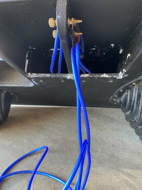

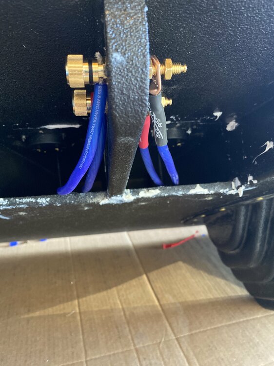

Picture this, just inside your enclosure as long as you can reach it. My box is under seat so this was best placement and way to run in series/parallel. Left side “cap” goes to sub 1, then sub 2 has a ring terminal connection along with another ring terminal connection that goes to amp! Enclosure is divided so I wanted to avoid a hole between them.
I bet those caps would accept 4ga, with minor trimming
That's perfect. I was going to run 4 awg from the amp to the box, only because I have a crap load of 4 awg and the amp will except it for speaker wire, then 8 awg inside the box to the speakers. That's nice, it'll keep me from having to buy 8 awg ring terminals🤣 save me $8 lol. Thanks!
