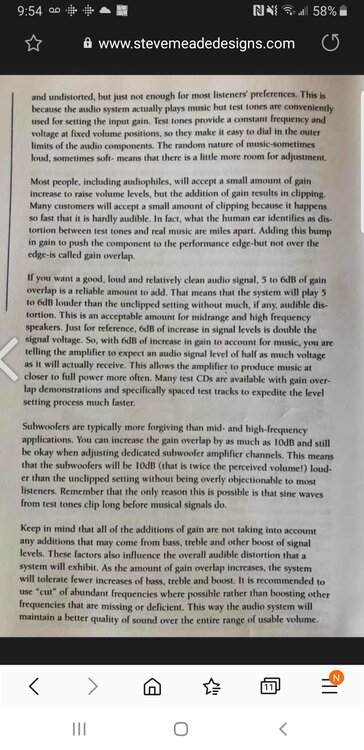

Also, when setting gains, should I go with the -5db tone on the 4channel and use the -10db tone for the sub amp..or.. Go with -5db tones for both? I listen to 70’s and 80’s classic rock and just want that clean, crisp and loud full range sound.

As far as the first question, I think @Bakermanexplained it perfectly. As far as the second question, I refer you to this

I will set my max volume to the lowest clipping setting of 11 and then I will used -5db and -10db tones for setting the mid and sub amps.
