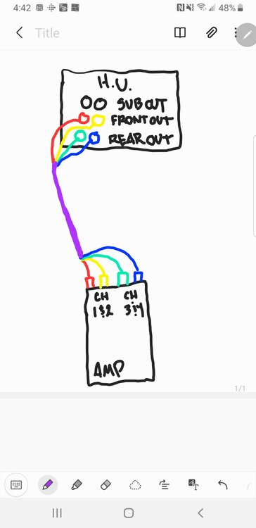

The head unit has sub, front, rear. But the Amp has input for each channel so I assumed it would need 4 rca. Do the 4 channel RCA have 4 plugs to Amp and two to head unit? Or is it 4 and 4? Just trying to picture the setup lol
The 4 channel RCA's are 4 for head unit, 4 for amp. So, you should be able to use the 4 channel RCA's. The 2 front head unit outputs to channel 1 & 2, and the 2 rear head unit outputs to channel 3 & 4. Hopefully this drawing makes sense

I was imagining one rca set per speaker but one plug left, one plug right... I feel stupid 🤣 thanks for your help
