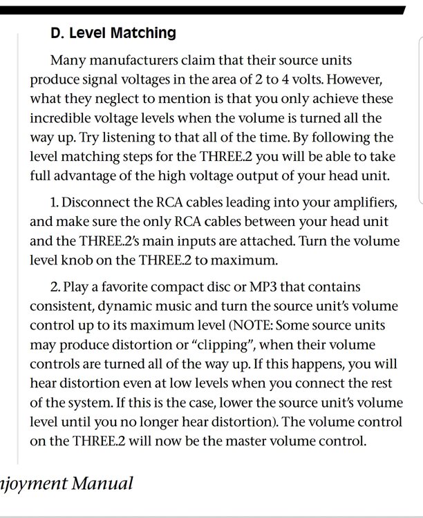

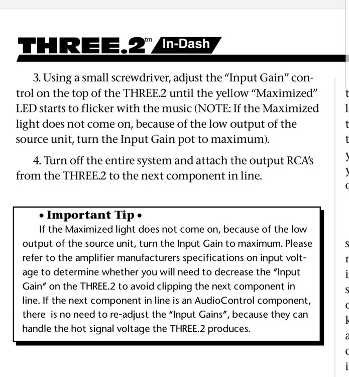

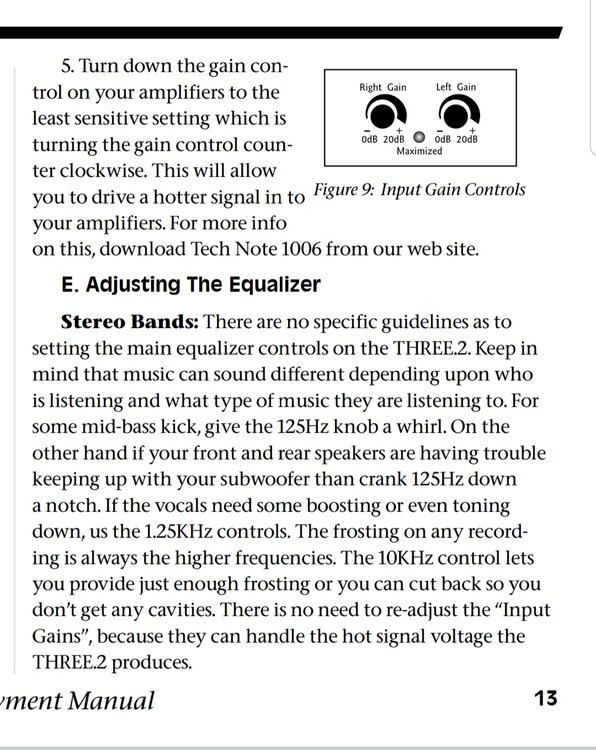

I'm not familiar with that deck or it's problems, but I think I follow your question... maybe... I'm sorry if I don't...
Look into the Audio Control Three.2 in dash processor. It has a bass knob and a volume knob, some other fancy things, but you can actually adjust the rca voltage out (to a certain extent) from the unit. Go to the audio control website, download the manual, and read it. If I understood your question correctly, I think it'll help. Here's the section in the manual I think will help. Level matching. Again, sorry if this wasn't exactly your question20210107_213253.thumb.jpg.a2404dcd4810e03bedadecaf8a609cd7.jpg
