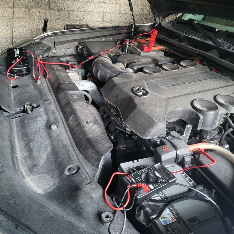

Kyblack76 Posted May 5, 2022 Author Report Posted May 5, 2022 Welp, after owning more than a few (from 12 to 16) xs power chargers,.. i nabbed a noco for fun. Lil fuck seems quite nice. Time will tell. SMD SUPER SELLER The Burban Build Blazer Build sold Acura trunk build sold

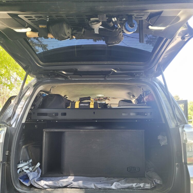

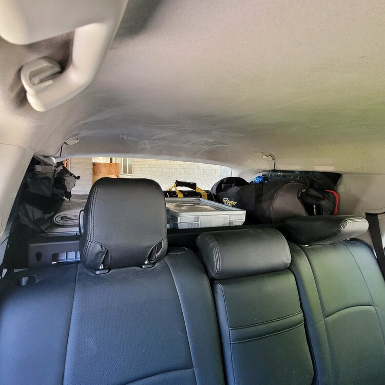

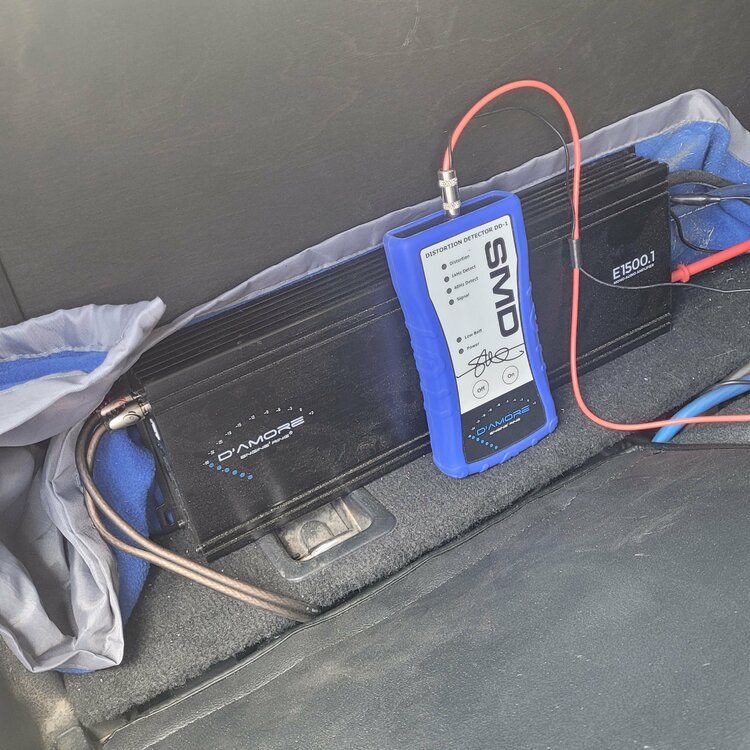

Kyblack76 Posted May 26, 2022 Author Report Posted May 26, 2022 Found that the head unit is clean to full/max volume. Set the sub amplifier at -7.5db overlap. I was close, but now I know the head unit is clean (my biggest want) and the board is set with my prefered overlap. Good shit. Gets down ok. Next, is fighting the roof rattles. I want to get into the headliner, put some mass up there in a few specific areas, and i think thatll help a ton. Also ran sweeps and saw what the vehicle and enclosure like. It has a super flat responce, barely losing a db in 20 herz. It has a nice nice "peak" around 28hz, and then again around 40hz. Its kinda acting like a band pass. I dig it. Im glad the vehicle resonates low. On to rattle fighting. 20220523_131052.mp4 SMD SUPER SELLER The Burban Build Blazer Build sold Acura trunk build sold

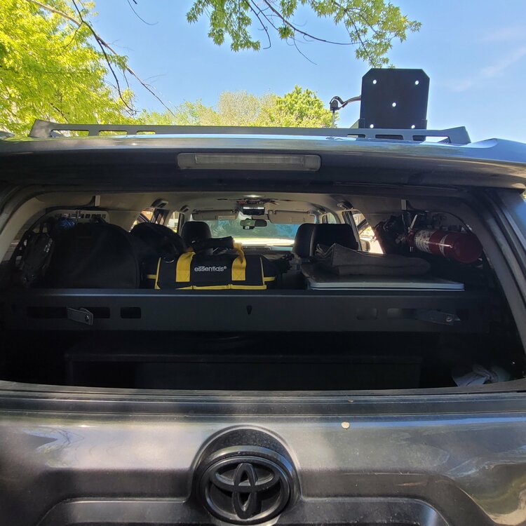

Kyblack76 Posted June 5, 2022 Author Report Posted June 5, 2022 On 6/3/2022 at 8:19 PM, strangeduck said: had to go back through this to refresh my memory. looking good man! Yerrrr,.. whats cracking homie. Its coming along pretty decent. I kinda wish id done 12's (the space) but, this lil molle panel and shelf system is pretty dope, and glad it actually fit. I dig it. Hope you and yours are well homeslice. SMD SUPER SELLER The Burban Build Blazer Build sold Acura trunk build sold
