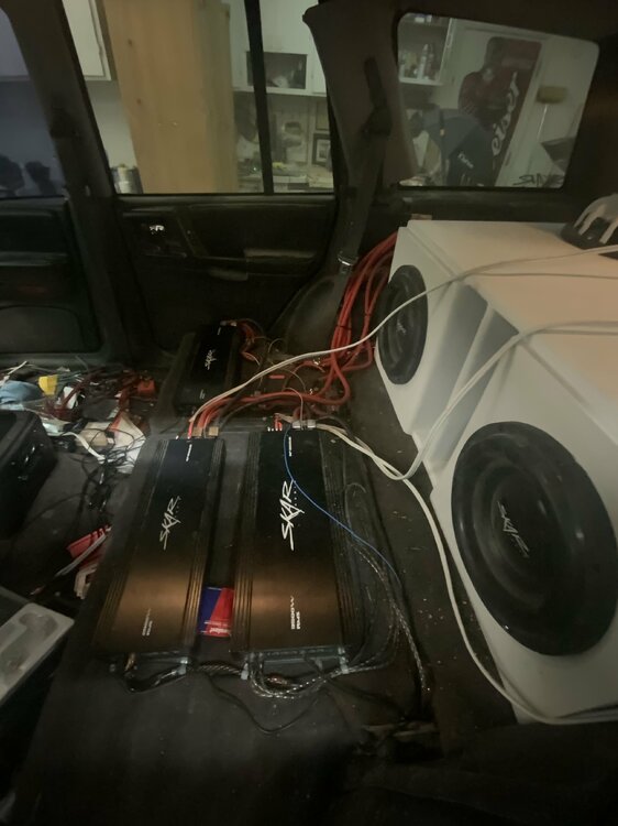

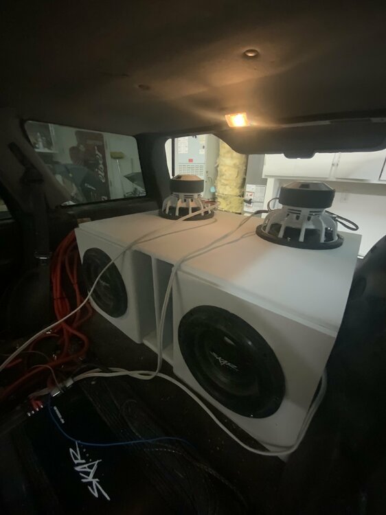

I have a SKAR RP 3500.1 D powering 2 4Ohm EVL 12s and I also have 2 SKAR RP 2000.1D powering 2 more EVL’s at first not much was audible in difference. After break in that changed greatly, the 2000.1D’s are more than plenty for those subs. Running single sub per amp I should of gone for the 2Ohm instead of 4Ohm but this kept me at safer levels. The 2000.1 does have enough in it to get those subs close to the limit but they are way less taxing on the power system. I dropped to 11.5 V on stock power with the 2 with the 3500.1 by itself I dropped almost to 8 but gave way better return being at 1 Ohm. If choosing out of the 2 I’d go with the 3500.1D, it’s strap-able, and as for size it comes in about same length just fatter and heavier plus greater adjustability. Although price per watt the 2000.1ds are cheaper for more.so if you have 4 Ohm the 3500.1 if you have 2 ohm do the 2000.1s one each.
