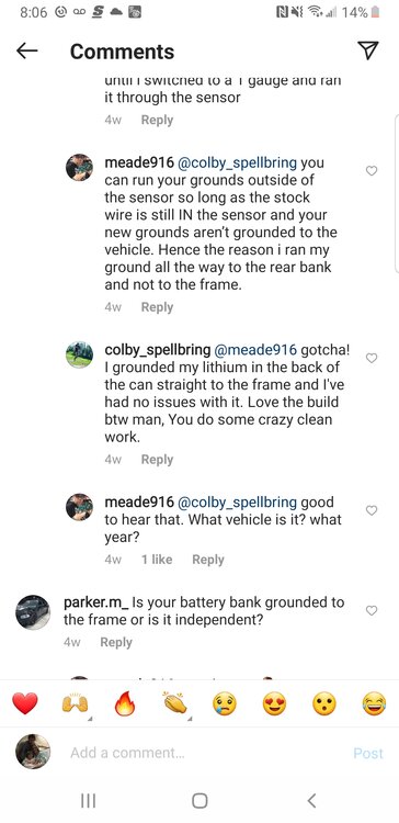

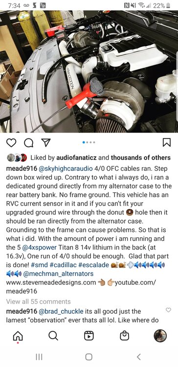

Dafaseles Posted April 25, 2021 Report Posted April 25, 2021 My stock battery is in the same location and I think I know what you're looking at. Looks like it goes straight down almost right at or just behind the wheel? Mine had that too, (didn't go through the donut though) but I assumed the stereo shop that didn't know what they where doing put that in because my cousins (who again, is untouched) didn't have that. Have you had any work done to it before? Did you buy it used? And if so, is there any indication that there might have been an aftermarket stereo in it before? Anyway, I took screenshots back when I first learned about the truck having the RVC. It was actually an Instagram post from Steve Meade. After i raff these 2 things, i started asking around and watching YouTube videos. Then @1point21gigawattsand myself came up with my plan. 2011 Chevy Silverado under construction My build log here. Check it out!
