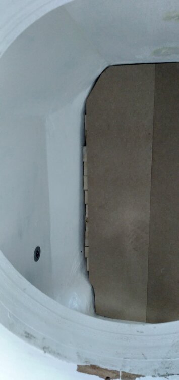

I had loading issues with the subs, for over 4kw per sub demoing, they were moving quite a lot.
From preview experiences I know these subs like to play in smaller volumes than usual, so I planed to modify the wall.
The easiest way to reduce the volume was to reduce the depth, that's a good point as reducing the depth will help controling the excursion.

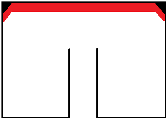

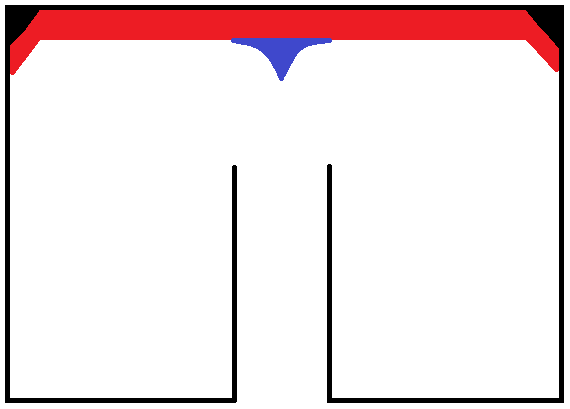

To be clear, I draw something to be sure about where to go, here's the drawing (seen from the top).
I added also the blue part, as told by my SPL specialist friend, could help with the output.

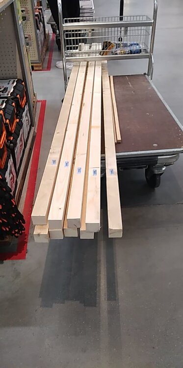

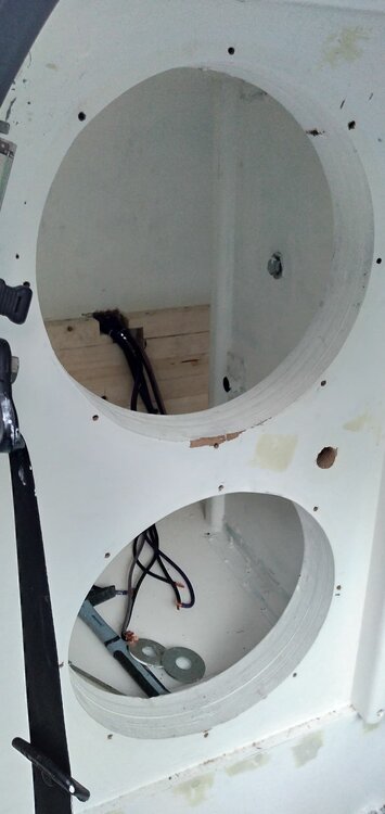

I bought some 60x60mm wood bars to reduce the depth (all the empty spaces you'll see in the next photos were filled with foam + fiberglass + resin).
123579766_355102835592449_5442606928403968084_n.thumb.jpg.1a1d7faeef47a105c6806839589b3a7e.jpg

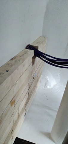

Pain in the butt to get these bars double screwed (screw between the bars + screw from the rear of the wall) and glued.
124931286_727889221409061_6969683283779416667_n.jpg.0fcad05d0ce55af087c60c320e839de6.jpg124854315_815416562363144_6556242692670295285_n.thumb.jpg.c5446fac61fd4b416383d64f2d285491.jpg
then a small MDF board to make everything smoother (as I said the empty spaces were filled and reinforced).
126127134_389418328875547_7433640034666722016_n.thumb.jpg.78386eadf22372f7d606245a6ab7eb7e.jpg

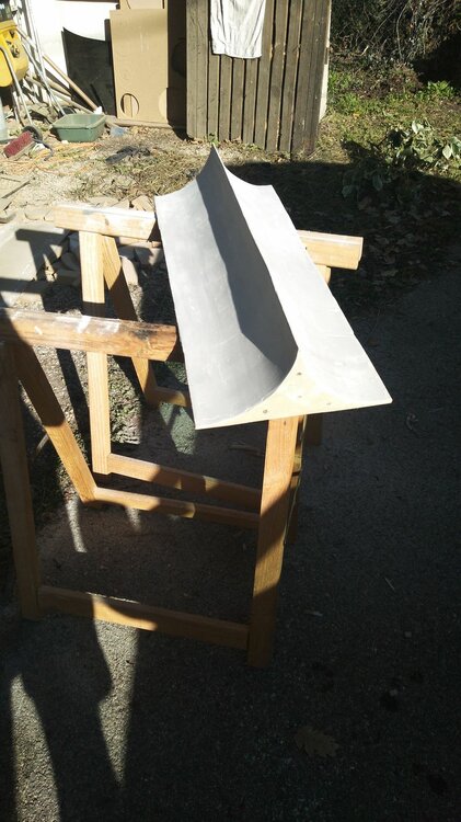

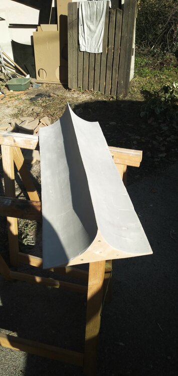

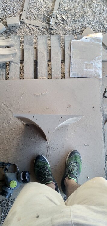

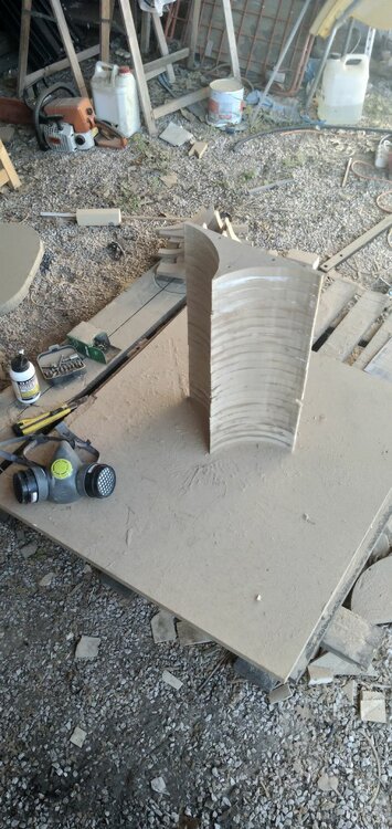

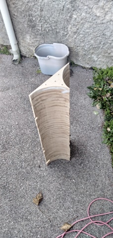

The main job with this was the middle piece (remember that blue part on my drawing ?).
I wanted to do something strong, so I went for an MDF stacked piece.
126174663_282815809812278_380161618327093857_n.thumb.jpg.78da39676c273deceb884fdac635ed93.jpg126459188_179405787136837_277610025239169798_n.thumb.jpg.98c87f8ff94296f32befae9ea8637e8d.jpg
126155840_740114553523770_2123597902639225637_n.jpg.265fb81783d98dc4d3be32d5e237601c.jpg126165308_401792231174607_7911734480506238340_n.thumb.jpg.8e16d9a3802cebf6d73d6f56050cfe3f.jpg
A few layers of putty and sanding and it's looking correct

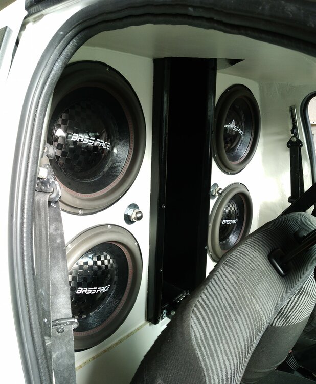

Here's why I made a dismountable rack in the trunk, it's so easy to put take everything out and all back in again
123106834_3802788566400190_6262836854316394956_n.thumb.jpg.7b7868ed41501225f0f367e2f6afeebd.jpg123051125_1617813411744412_8308713899163102435_n.thumb.jpg.e83d8f75f8508650520bf01fad672ce0.jpg
I've made some modifications on top of the car, close from the windshield, to fill all the holes, but I have no photo also...
I made a bit of painting then I put everything back together on front of the car and wow, new look is, I think, cool :D

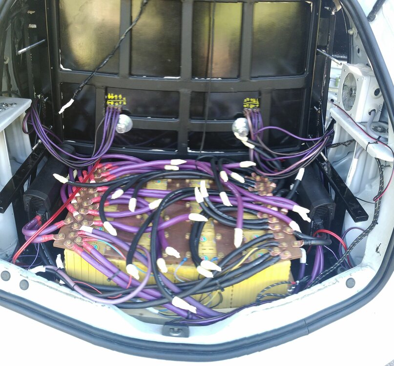

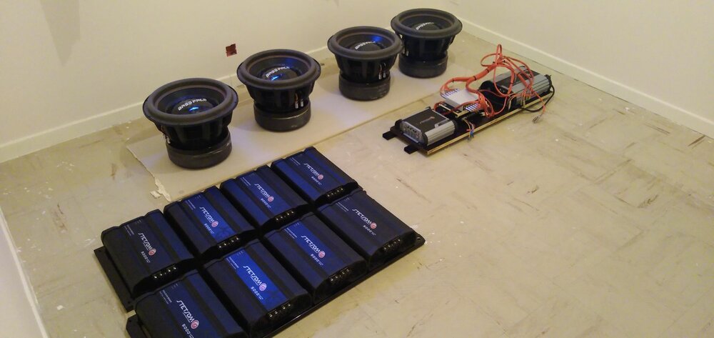

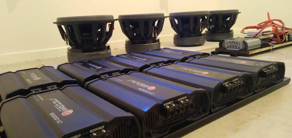

Sneak picture of the back, where you can see how painful it is to wire that many amplifiers in a such small car.
You can also see the midbass amps on the left and right.
