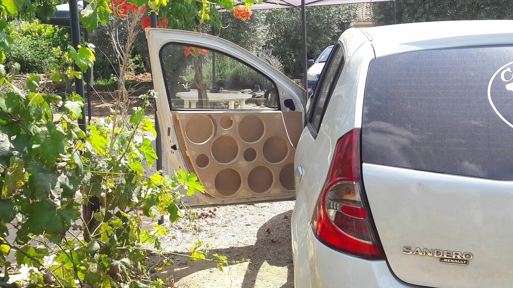

I always made my door panels with the stock panel, some wood and fiberglass, but for this build I wanted to do something stronger.
By reading and watching what you guys do in the US, I went with a simple design.
2 wood boards, one at the back of the panel agains the metal frame of the door, and one holding the mids and highs.

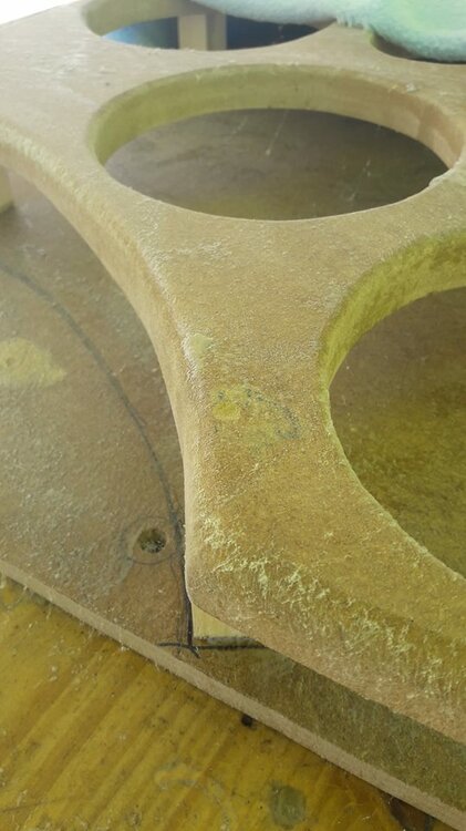

First I made a thin board matching the form I wanted to give to the, then copied it to a thicker board, I put M8 (5/16" I think) bolts through the original holes in the metal made for plastic clips to hold the OEM plastic panel.
These bolts would later hold the final pannel without making more modification to the OEM door.

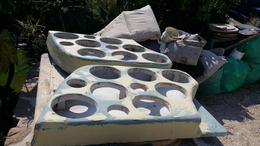

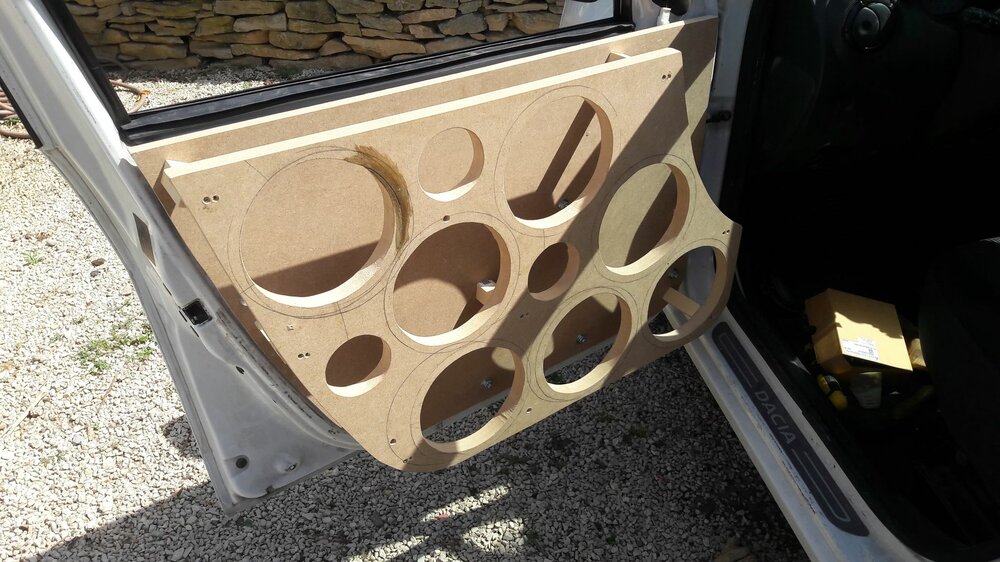

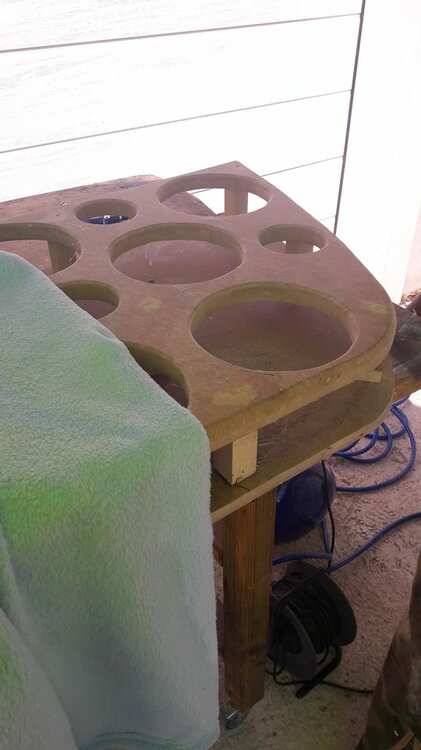

With that first done, I copied my "test" board to thicker boards (1" MdF), I used some wood pieces screwed and glued to hold the assembly together.

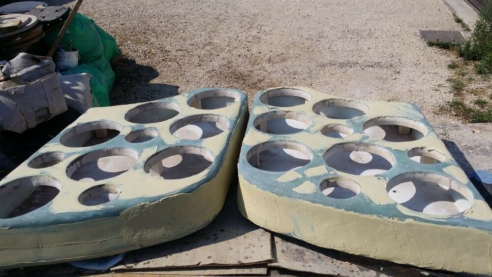

Then I glued the panel and wrapped a blanket before going wiht the resin / fiber glass process.

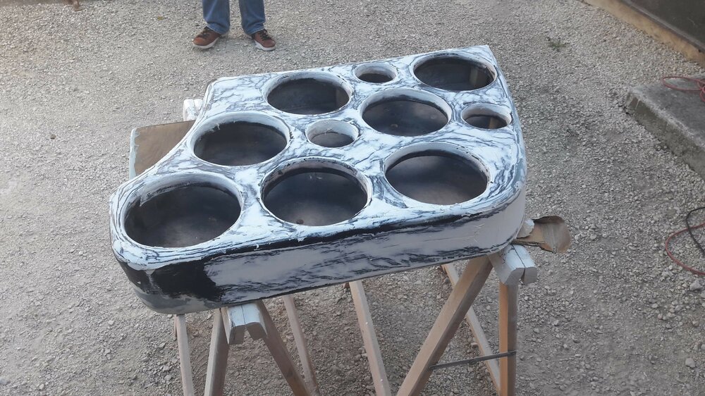

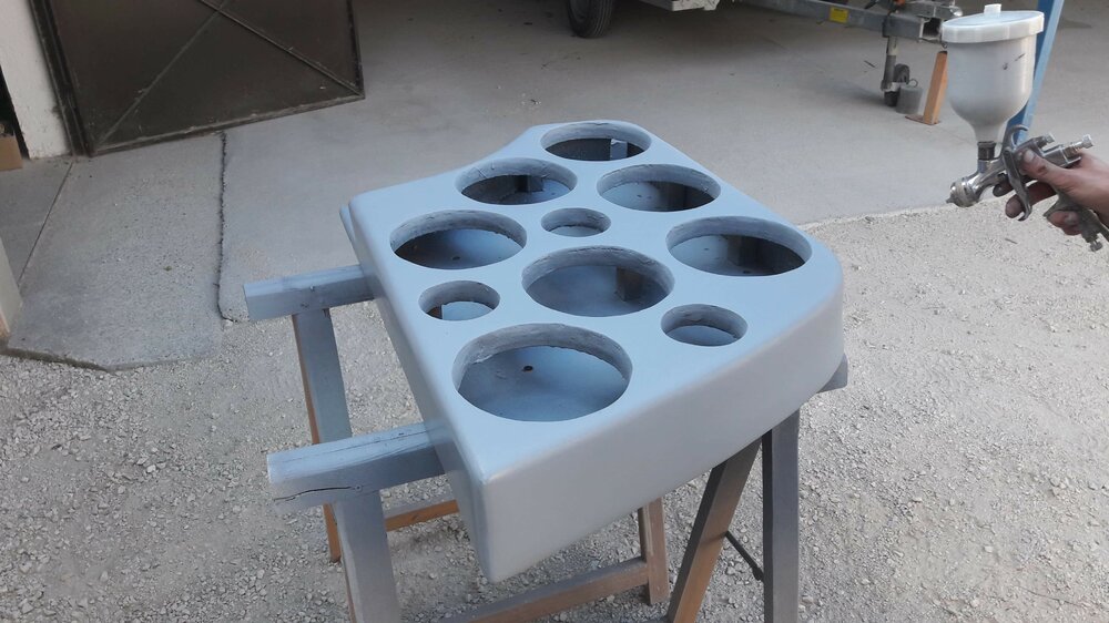

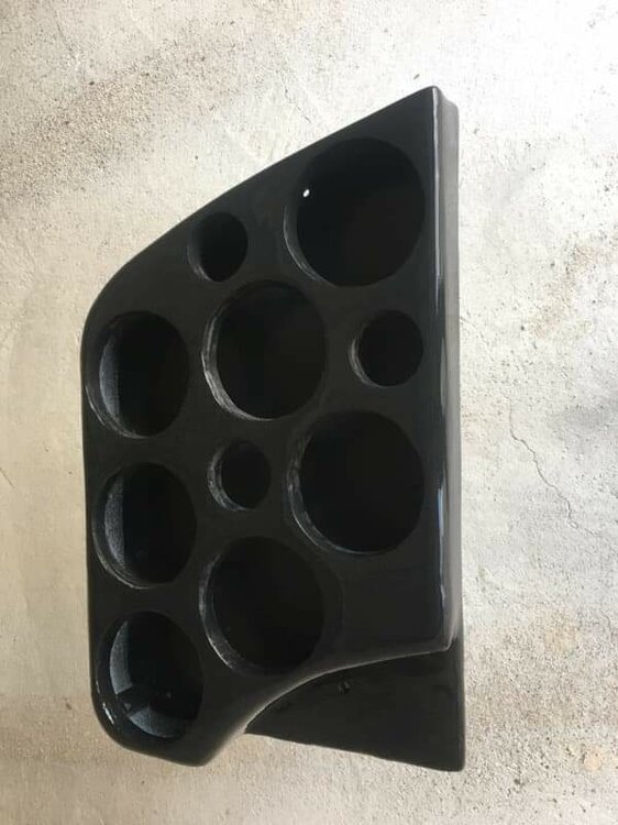

Then, time for sanding, putty, sanding again...
The panels finally were looking how they should.
Finally went for more sanding and black mate paint.

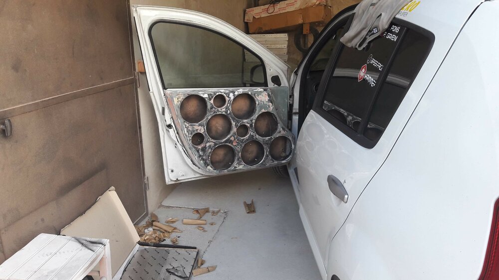

2 hours ago, 1point21gigawatts said:
How did you mount them door pods to that metal door skin?
As I said (maybe I wasn't clear lol), I put M8 bolts where originaly the plastic OEM pannel is clipsed.
Then I just made holes in the wood to be able to put the wooden pannel against the metal frame, through the bolts, and secured with locking nuts.
I'll try to find a photo of this.
You can already see the bolts here when I made my test board.
I'm not sure to have more photos of the bolts.
Of course as you can see in the picture above, there are not many bolts and they are short. This was a test fit.
On the finished door I have longer bolts, 10xM8 + 2xM6, I had to do with as many because the wood + speakers only weight about 80 pounds.
