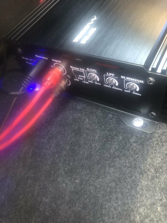

SkarMan Posted June 22, 2021 Report Posted June 22, 2021 I installed my subs today but after I test the install they don’t produce the base I thought they where going to even with bass boost on Specs: skar 1500d EDIT: Gain, lpf, and subsonic are all turn to the lowest setting 2 skar 12s 4dvc wired to 1 ohm 4 gauge power and ground my issue: after I turn it up so much my amp goes into protect mode, my stock alt can’t handle (110a) so they dim a lot after so much but even at a reasonable volume I still don’t get a boom. I will go back through my grounds but I need help

Car Audio 83 Posted June 22, 2021 Report Posted June 22, 2021 2 hours ago, SkarMan said: @Car Audio 83 @DafaselesBy flat I mean none of them are turnt up not even bass boost. It’s the Skar 1500d monoblock amp Then you have your gain at 0, which can lead to 0 (or almost 0) output. You LPF is at 50Hz, which, depending on what you are listening too can be too low. Try to turn a bit the Gain up (maybe 1/8 or 1/4) to see if you have any bass coming. Nota : I just saw, if you turned the gain too high earlier, this could have broken the amp, hard to tell here, you'll need to tell us more, send photos maybe..

SkarMan Posted June 22, 2021 Author Report Posted June 22, 2021 This what it is as of now if I turn up the bass boost it goes it to protect mode if I turn the gain up to much it does it I think it’s my car lacking electrical power
