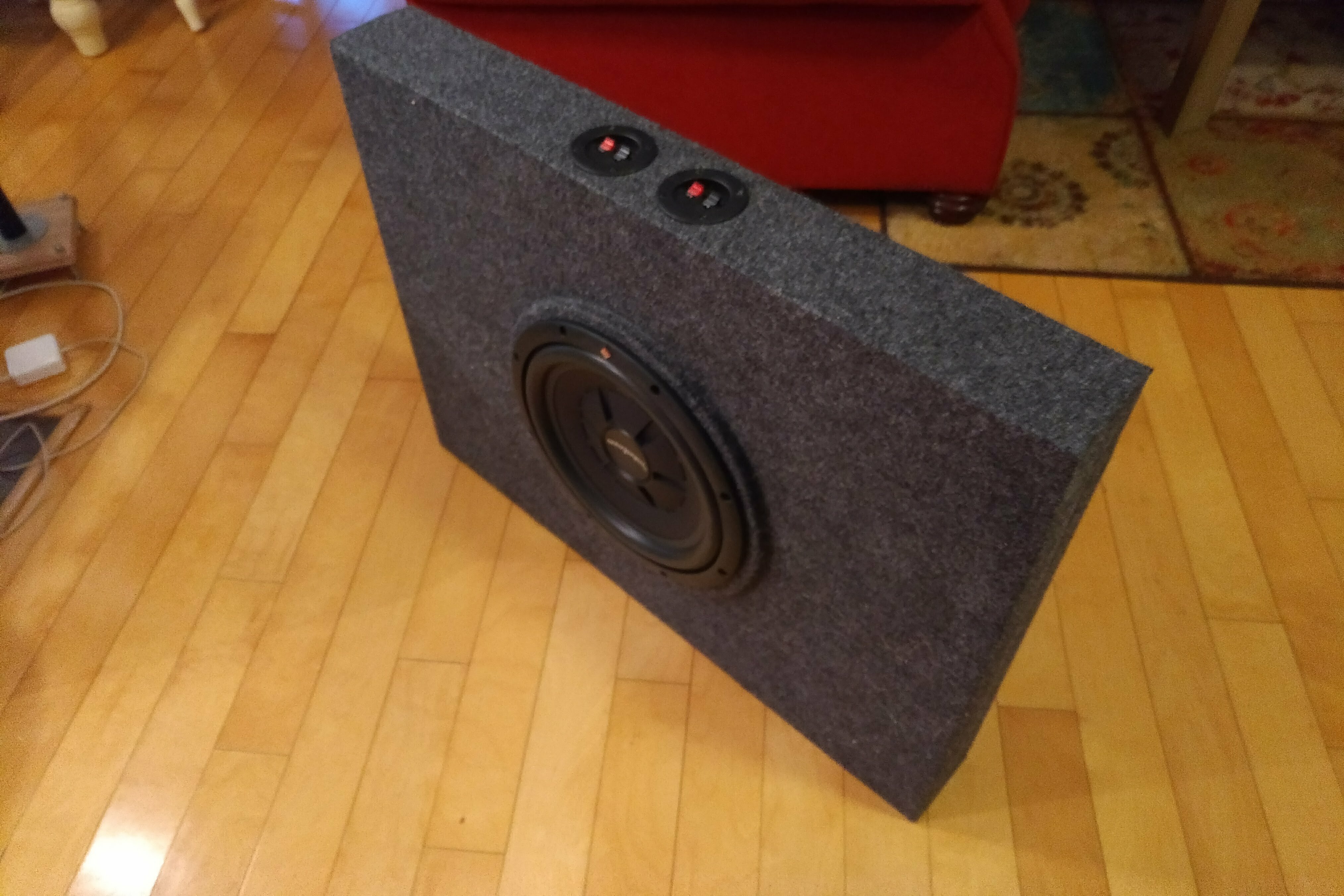

- Rockford-Fosgate R2SD2-12 low profile sub, in a 0.95 cu.ft box.

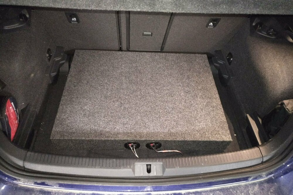

For the sub, the only issue is the space underneath the floor - it's only about 4-inches of clearance. The box I built takes up a good portion of the space underneath the floor, the size is 32 inches wide by 24 inches deep, by 4 inches tall - this gives me about 1 cubic foot of airspace, sealed. See photos attached of what I have now.
I am definitely open to making another box so long as it leaves me my trunk space (so an in-floor box, I could also make the box the actual floor and put grilles on the subs to make the box slightly taller, removing the OEM floor cover)
Curious if one powerful 12-inch low-profile sub (maybe 400-ish WRMS) would do better than two 8-inch subs with around 200-250wRMS each? I have only had 10-inch and 12-inch subs in my vehicles, and so less experience there!
Man, with only 4" mounting depth, I think thin subs are your only option. Even the 8's I looked at need at least 6".
JL's TW5 12" only needs a little less than 4", but I know you don't want to spend a whole bunch on the build, and that's an expensive sub.
