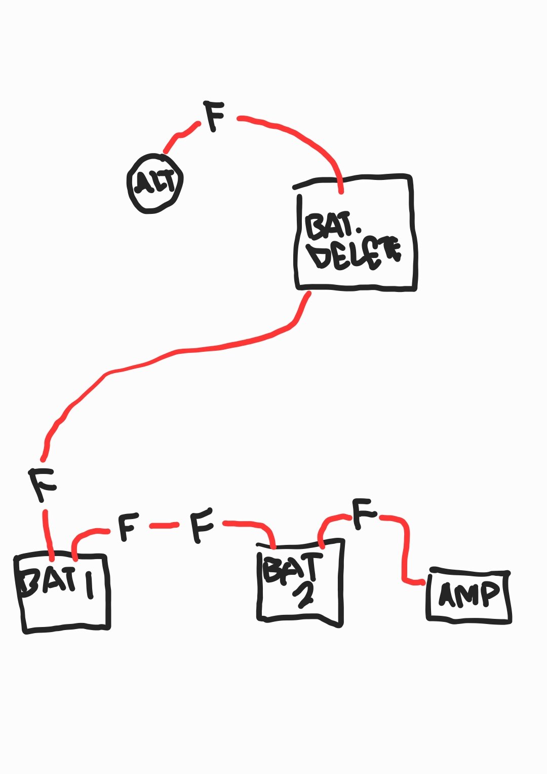

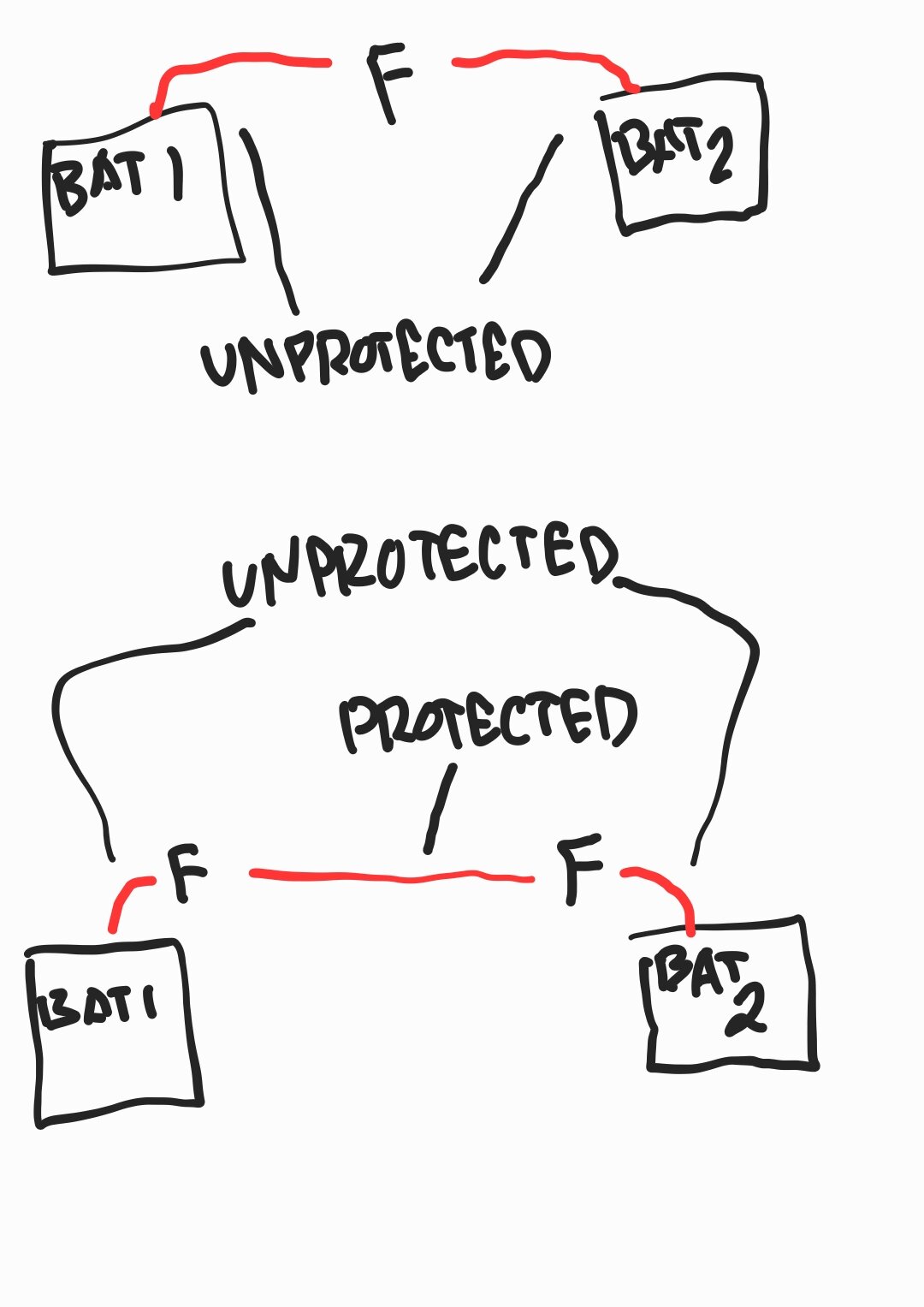

2 hours ago, Never Enough Bass said:
I have 3 300a fuses 1 on the big 3, 1 between batteries and 1 to the amp
So, in regards to fussing, electricity doesn't just move in one direction. If you want to be absolutely safe, you'll need 2 fuse points.Notes_210817_085621.thumb.jpg.ee26baf7a1fc8fe960f7b9ce306d701f.jpgsothat's how you would be 100%safe.
The whole deal would look like thisNotes_210817_085404.thumb.jpg.5501168098a34d70272e128cdbca9f2b.jpgwith your batteries being so close together, you don't necessarily need any fuses between them. If you just check on your wires every now and again, make sure there's no burning, you'll be fine. Maybe even add another run just to dispers some of the load. If there's any wire that you can't see between them, then definitely fuse them.
Mines like the second pic
