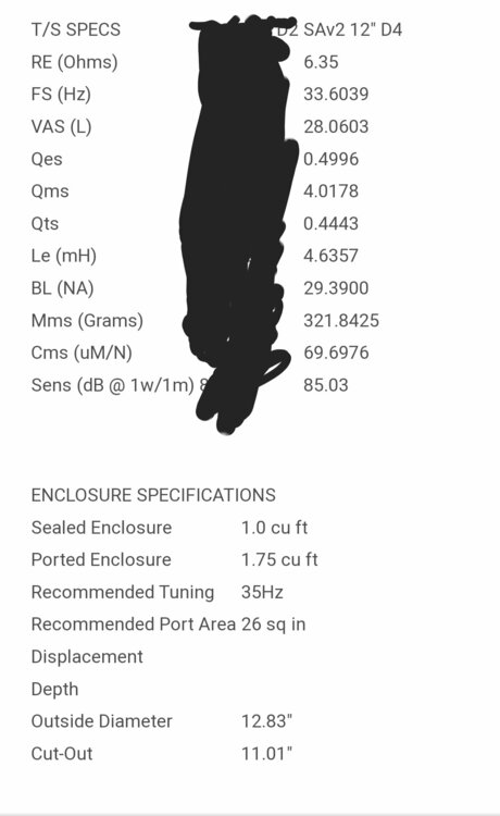

So no luck on one that fits my car can anyone help me with a design so I can build my own. Dimensions 32L×20w×14h the width can go bigger if need be I'm not worried about functionality but I would like to have it that's about what I need basshead problems right there. Subs on sundown website recommend at 35hz tune but whatever is best. I'm feeding these hungry hippos a sia 3500 any assistance would be greatly appreciated if this helps I looked this up

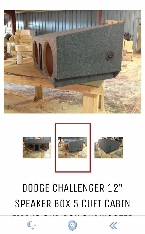

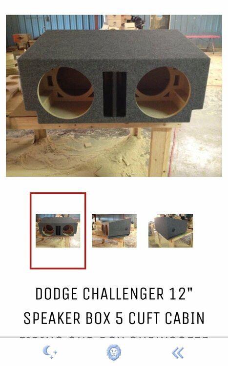

It could look like this I don't have a backseat anyways fire into the cabin and I could seal it off make it 22 deep

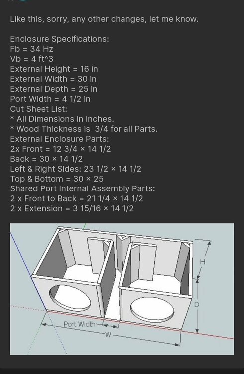

If I change this from 30 to 32in and 16 to 15in what all else to I gotta change to keep it around 34 hz
