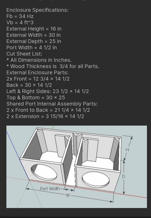

AdamB126 Posted August 31, 2021 Author Report Posted August 31, 2021 Does this box seem like it would work? Box Design
Never Enough Bass Posted September 8, 2021 Report Posted September 8, 2021 I'm gonna build this for my sundown sa 12's in the back of a Charger on 3500 rms 06 Charger Pioneer double din Pioneer 6.5 and 6×9's Knukoncept Krystal kable rca's 0 ga knukoncept kolossus wire Big 3 same wire ^ 1 run 8g karma ss speaker wire Sundown sia 3500d at 1ohm 2 Sundown U series 12's Duralast platinum agm H7 (Main) Xs power d3400 Trying to find a ho alt
Never Enough Bass Posted September 8, 2021 Report Posted September 8, 2021 But I'm going down a inch in height and out an inch in width 06 Charger Pioneer double din Pioneer 6.5 and 6×9's Knukoncept Krystal kable rca's 0 ga knukoncept kolossus wire Big 3 same wire ^ 1 run 8g karma ss speaker wire Sundown sia 3500d at 1ohm 2 Sundown U series 12's Duralast platinum agm H7 (Main) Xs power d3400 Trying to find a ho alt
