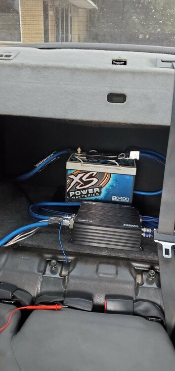

Dafaseles Posted September 3, 2021 Report Posted September 3, 2021 2 hours ago, Never Enough Bass said: That box looks right at home in there! 2011 Chevy Silverado under construction My build log here. Check it out!
Never Enough Bass Posted September 3, 2021 Author Report Posted September 3, 2021 I don't think it's big enough but it's gonna have to work for now 06 Charger Pioneer double din Pioneer 6.5 and 6×9's Knukoncept Krystal kable rca's 0 ga knukoncept kolossus wire Big 3 same wire ^ 1 run 8g karma ss speaker wire Sundown sia 3500d at 1ohm 2 Sundown U series 12's Duralast platinum agm H7 (Main) Xs power d3400 Trying to find a ho alt
Never Enough Bass Posted September 3, 2021 Author Report Posted September 3, 2021 Got it all wired just needs some fine tuning 06 Charger Pioneer double din Pioneer 6.5 and 6×9's Knukoncept Krystal kable rca's 0 ga knukoncept kolossus wire Big 3 same wire ^ 1 run 8g karma ss speaker wire Sundown sia 3500d at 1ohm 2 Sundown U series 12's Duralast platinum agm H7 (Main) Xs power d3400 Trying to find a ho alt
