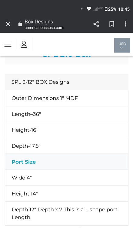

This is my first post and wasn't 100% sure where to put this. So I have watched every single YouTube video about ported sub box making and tuning and read forum after forum it just makes 0 sense to me. Nothing I read/watches makes sense. I've tried those online "port tuning calculators" and I use same data for both and get completely different results. So I've given up trying to design one myself and went on American bass's website and they have these wonderful charts. However they don't have one for two 15 inch subs. I was wondering if I made changed the length and height to 18 if that'd be sufficient enough for two xlf 15's? If anyone can help me it'd be very much appreciated you have no idea how frustrated I am with this. Thanks!

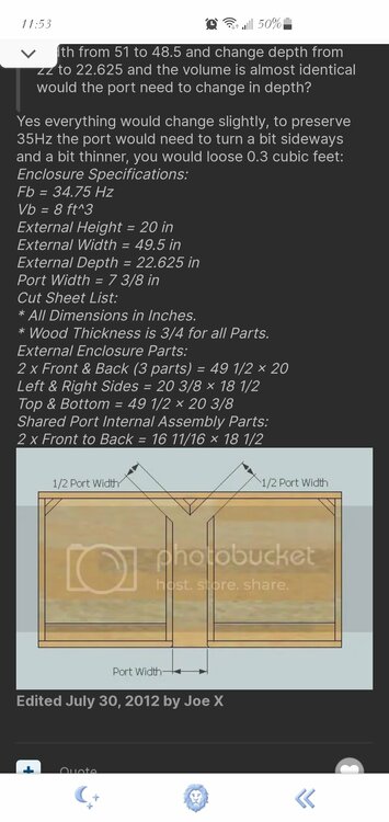

I found this in the forums for your subs for a avalanche

Just search the forums u may be able to find something or u can buy a design for your vehicle and subs
He can’t just search forums to find a custom enclosure design suited for his build just because the subwoofers are the same in other designs. The rms comes into play and the vehicle comes into play and the preference of what the person is looking to gain out of their car audio system in reference to the sound.
:guido:
Yea that's why I said he may be able to. I'm sure a lot of stuff is gonna be better than that pre fab he's looking at
