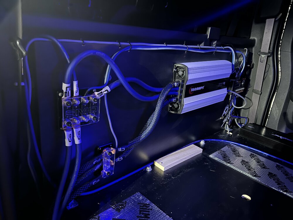

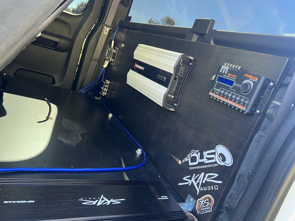

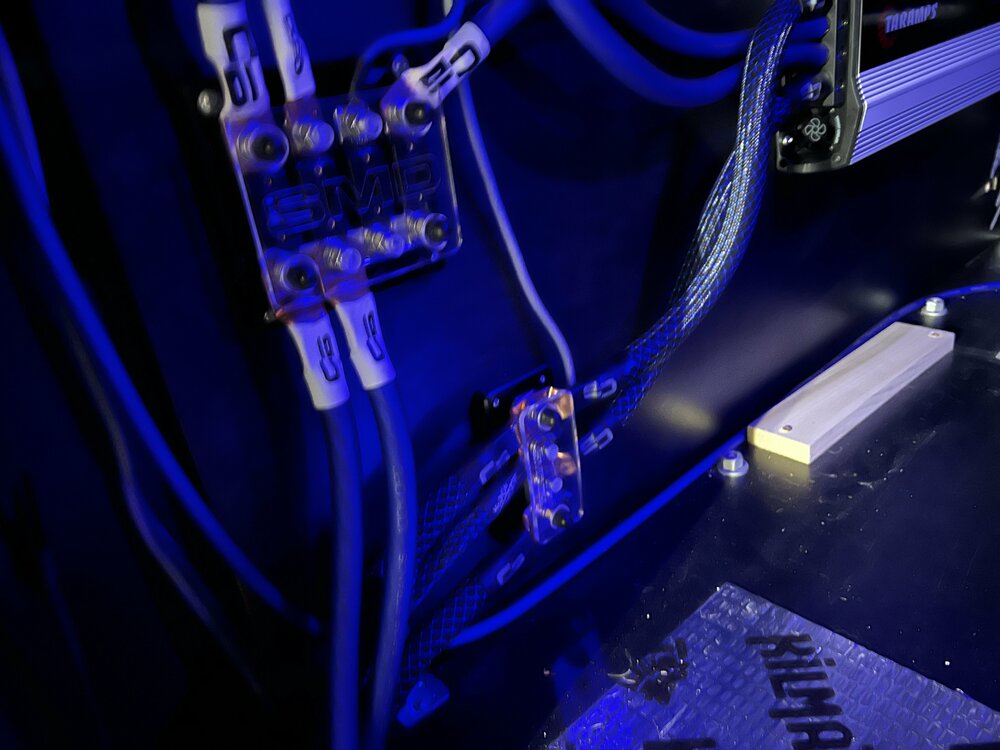

Thank you guys ! Yeah I’m pumped on it, their shop does some crazy wood working and he knocked it out of the park. Should be playing Sunday, low power and break the subs in for a little. I got everything mocked up, now I gotta just run some wire, swap a battery and throw the subs in. I got 2x d3400 on stock alt so will see how that hold ups on the smart 5k and skar rp 1k. Alternator is probably in my future. More for extended listening.

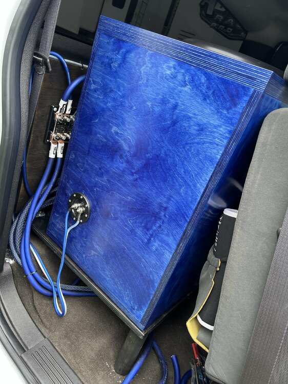

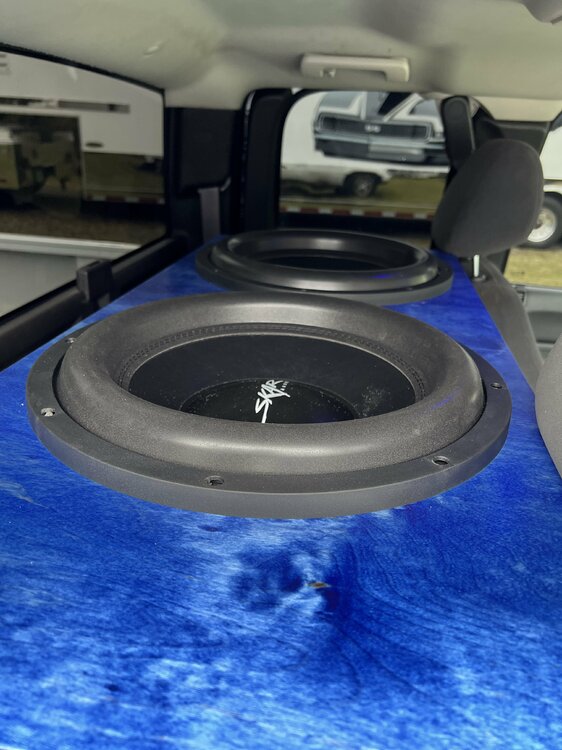

Okay !! Got everything set up and have been playing around with it for a couple days. Still have them on barely half power that they will get clean and they absolutely slam !! I will get some vids when I got them on full power and broke in. I gotta keep messing and learn the setup and see where I wanna go. Right now box is 6.3 net cubes 132 port area tuned at 36hz going to be testing this setup and then possibly try 108 port area at 33.5hz. I have to pull headliner out though immediately and put some thicc Deadener up there. May even leave headliner out or come up with something custom. I will see what it sounds like deadened and go from there. Then I can continue testing. Honestly I didn’t know what to expect, but I’m overall thrilled with the setup.

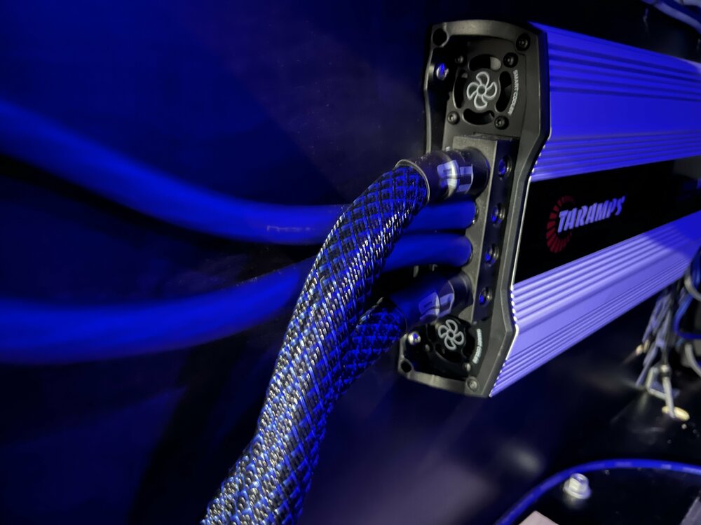

I'll tell you what, looks clean as hell! I love the cable work!
