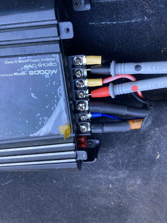

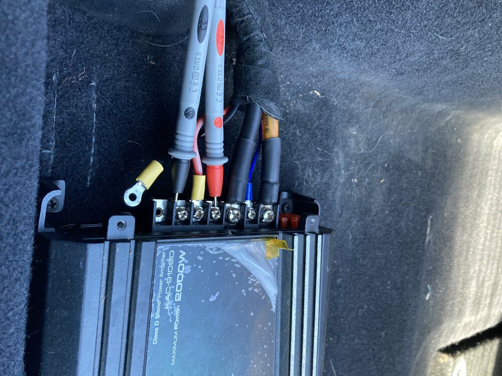

DD1User001 Posted October 18, 2021 Author Report Posted October 18, 2021 Here is where I set the amp. Please watch it and tell me if I missed anything or did anything incorrectly. My Subwoofer frequency defaults to 80 hz -18 which is why you'll see me change it back. I was flattening everything. Should I turn this to off when I am setting the gain? You can hear the way this sounds as its adjusted in the video. Image 1 is how I had the SMD DD-1 connected during configuration. Image 2 is what it looks like after configuration. I am fixing to take the car out and drive it to show you how the voltage will decreases over time.

DD1User001 Posted October 18, 2021 Author Report Posted October 18, 2021 SLA is source level adjustment. Its used for setting different source level volumes on different sources to match the AM/FM radio volume. Sorry for such confusion here, but I notice in the manual it says 10. Set the headunit's bass, treble, EQ, crossovers to flat. The headunit defaults on a factory reset to front HPF off, rear HPF off, and LPF sub to 80 Hz -18. Is this the right setting or should I also turn off the LPF frequency off too before I adjust the gains? I'm not sure where the amp ground is on the car since I let a shop do the install years ago. I will have to investigate this further and report back. The sound you could hear in the video was actually my alpine 610c's, because the headunit defaults to turning off all HPF frequencies. The sub itself was disconnected. That was actually the mids and highs at 59. The car is a 2001 C5 Corvette. The 200A monster fuse is connected to the read power wire going to the fuse.
