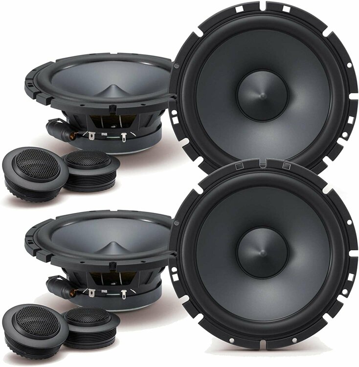

I bought this entire setup back in August of 2016. I first replaced the old stock system with a $100 8" bazooka tube and the default bose speakers. The setup before this never caused me any issues. The last image is what is in the doors now "Alpine 610c's". I believe the rear speakers are factory bose.

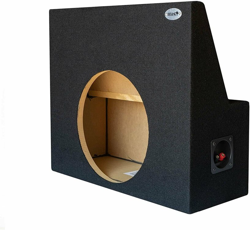

I wish I could fit something better, but a C5 has serious box size limitations and I have never found a full size box that would work for it to really make the bass come alive in this car. I'd prefer to use full size subs for more bass if I could. I just need a better box for the car.

Gotta build a box

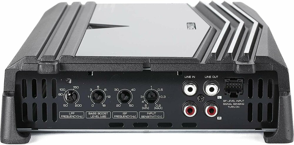

When I am talking about the gain at half with everything flat I mean this.
So, I don't know what you mean by flat, but the LPF frequency should be set around 80 hz. You have this setting on your head unit, I know, but I would set both the same. Bass boost should be at 0. If the bass boost is at 0, then that next knob doesn't work, and your input sensitivity should be set correctly using a DD-1, oscilloscope, or DMM.
