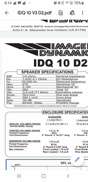

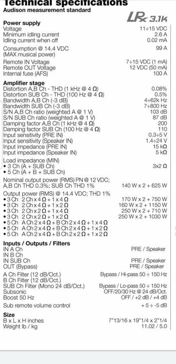

Patrick Camacho Posted October 20, 2021 Author Report Posted October 20, 2021 11 hours ago, Dafaseles said: Without me having to do a lot of clicking on links, what subs are they? Dual 2 ohm? Dual 4 ohm? Single voice coil? And what make and model amplifier is it? What is it stable down to? 1 ohm? 2 ohm? I don't mean to be rude, but rule number 1 on the internet.... don't click on unknown links 🤣 I understand and should have thought about that to. Sorry the reason why I added the file is when you look at most subwoofers manual it will say nominal impedance dvc 2 ohms or dvc 4 ohms and then pwr 500 watts but on this one its different cause it says nominal impedance 1/4 ohms and pwr 50/500. The subwoofers are Image dynamics IDQ 10 D2 V.3 and the amp is audison LRx 5.1 and I believe its stable down to 2 ohms

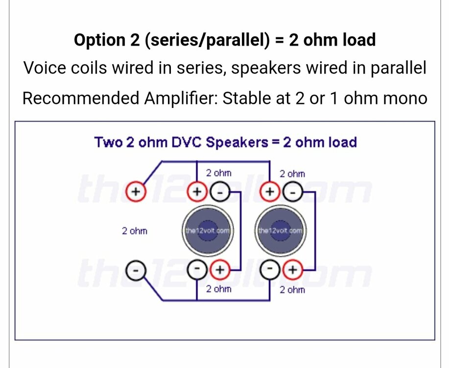

Never Enough Bass Posted October 20, 2021 Report Posted October 20, 2021 So they are 2 ohm subs run them in series 1 sub will be 4 ohms but when u put them together they will be 2 ohms 06 Charger Pioneer double din Pioneer 6.5 and 6×9's Knukoncept Krystal kable rca's 0 ga knukoncept kolossus wire Big 3 same wire ^ 1 run 8g karma ss speaker wire Sundown sia 3500d at 1ohm 2 Sundown U series 12's Duralast platinum agm H7 (Main) Xs power d3400 Trying to find a ho alt
Dafaseles Posted October 20, 2021 Report Posted October 20, 2021 You would wire the subs like thisfor a final 2 ohm load into the amp 2011 Chevy Silverado under construction My build log here. Check it out!
Patrick Camacho Posted October 22, 2021 Author Report Posted October 22, 2021 On 10/19/2021 at 6:50 PM, Dafaseles said: Without me having to do a lot of clicking on links, what subs are they? Dual 2 ohm? Dual 4 ohm? Single voice coil? And what make and model amplifier is it? What is it stable down to? 1 ohm? 2 ohm? I don't mean to be rude, but rule number 1 on the internet.... don't click on unknown links 🤣 I don't see where it says the speakers are 2 ohms. Thats why I wasn't sure because of the 1/4 on it. Never seen that before

Dafaseles Posted October 22, 2021 Report Posted October 22, 2021 1 hour ago, Patrick Camacho said: I don't see where it says the speakers are 2 ohms. Thats why I wasn't sure because of the 1/4 on it. Never seen that before The D2 means dual 2 ohm. Meaning you can wire a single sub to either 4 ohm, or 1 ohm. I'm not 100% sure what that 1/4 is as well. I'll look into it 2011 Chevy Silverado under construction My build log here. Check it out!

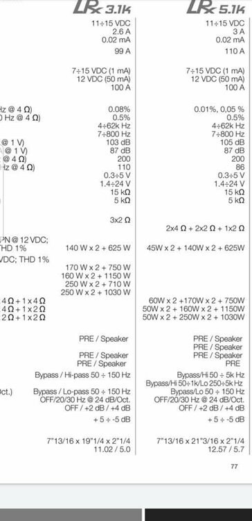

Patrick Camacho Posted October 22, 2021 Author Report Posted October 22, 2021 I appreciate the help guys. Just want to make sure I am doing it right and getting the most out of my amp and subs. I added the specs for the amp as well
Patrick Camacho Posted October 22, 2021 Author Report Posted October 22, 2021 I have the 5.1 by the way
