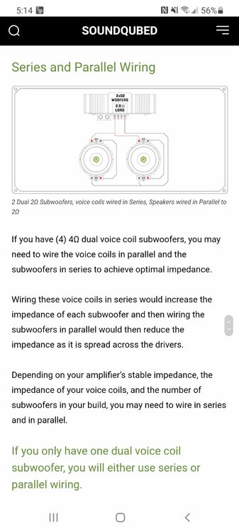

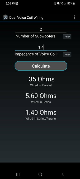

Dafaseles Posted November 14, 2021 Report Posted November 14, 2021 5 minutes ago, BLUE COLLAR MISFIT said: 2 This is what I got so I think I would go series parallel 2011 Chevy Silverado under construction My build log here. Check it out!
BLUE COLLAR MISFIT Posted November 14, 2021 Author Report Posted November 14, 2021 Just now, Dafaseles said: This is what I got Ok thank you so if I wire both subs in series then wire them both together I’ll have 1.4 ohms
Dafaseles Posted November 14, 2021 Report Posted November 14, 2021 Like this 2011 Chevy Silverado under construction My build log here. Check it out!
BLUE COLLAR MISFIT Posted November 14, 2021 Author Report Posted November 14, 2021 19 minutes ago, Dafaseles said: Like this Ok that’s what I was thinking just wanted to make sure that it wasnt gonna be below 1 ohm thank you. I’m ready to get this build going
