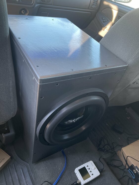

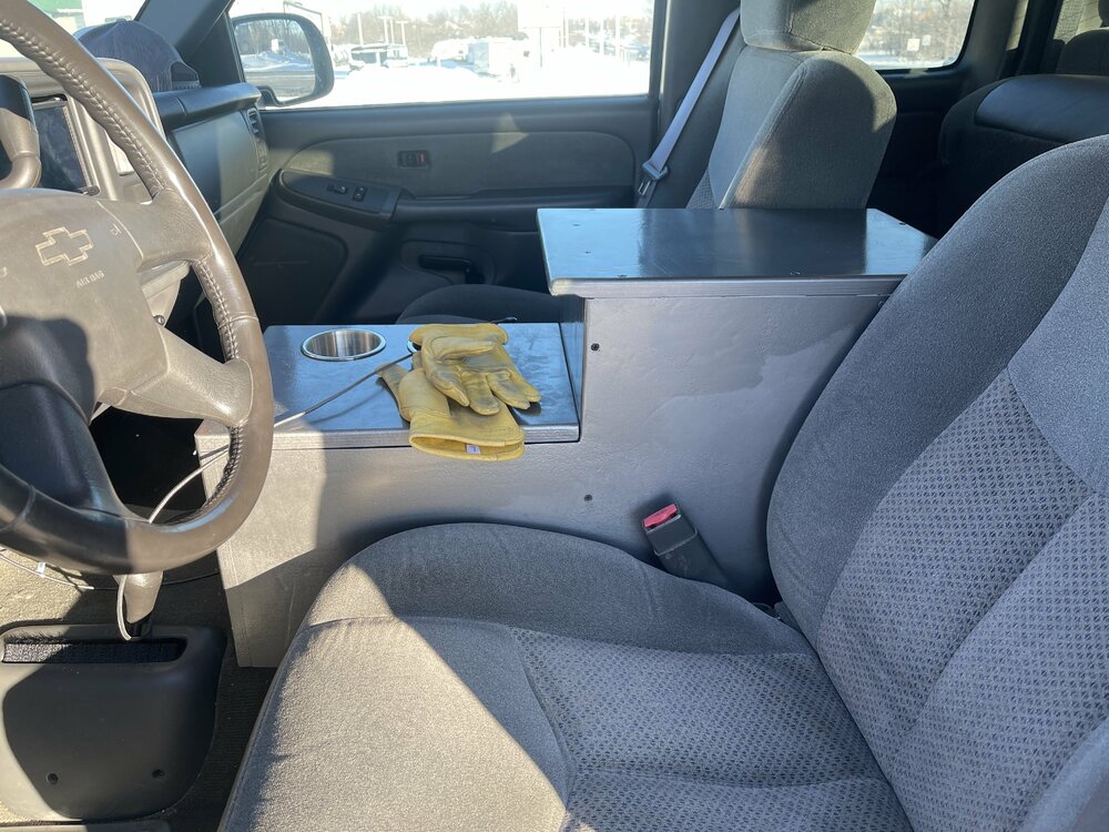

molly4lyfe Posted January 3, 2022 Author Report Posted January 3, 2022 Here’s 2 quick pictures to show the completed build. Not factory perfection but I’m very happy with it.
