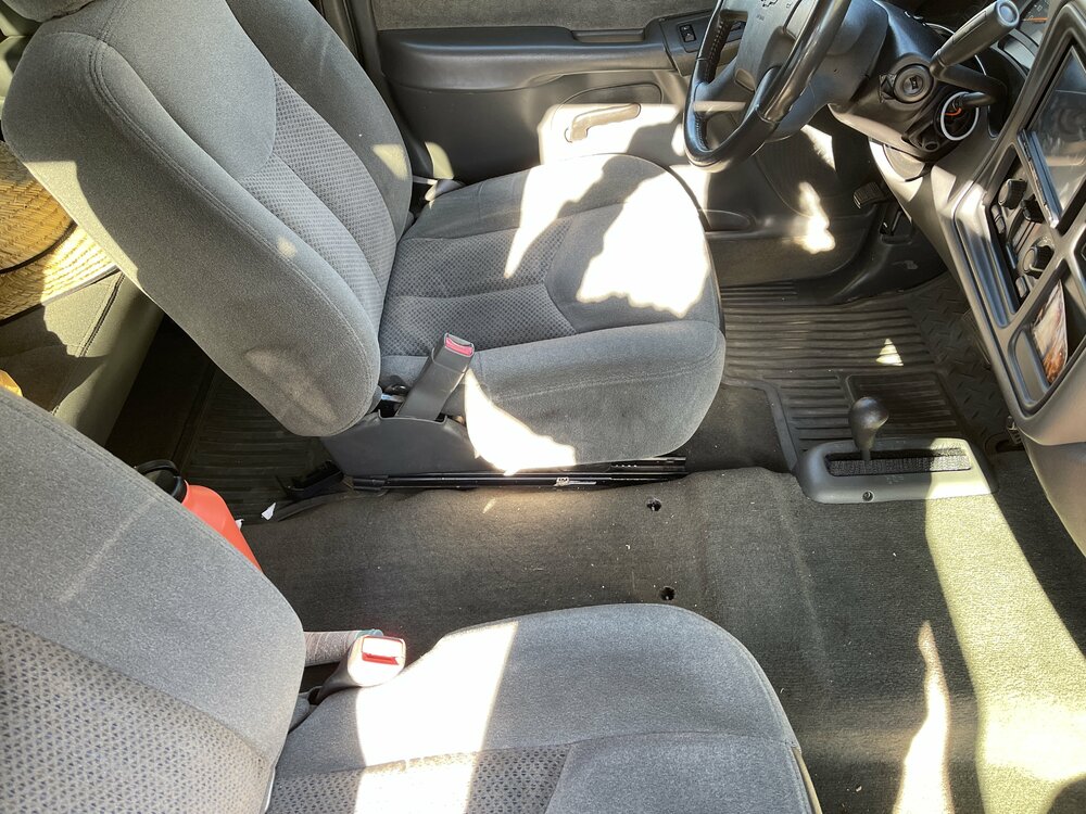

I ordered the Sub and amp on black Friday because they had a pretty nice deal. Ended up getting them last night. Id say that's a pretty good turn around time. I was also able to get the center console pulled out this morning. The only hiccup i had was the fact I don't own an E socket set so I had to borrow one from a friend. 8 bolts total and you can pull it out pretty easily. I still plan the start building come Thursday, I'm not sure how long it will take but I'm guessing a couple days. I also forgot to mention, the HU I'm running is a Sony XAV-AX3000. I picked it up around this time last year. Its not brand new at this point but its also not too old.
Thanks for reading

I had those same seats in my 99 Tahoe. I miss that truck.
Although my truck is no where close to new. I love this vehicle the most. And I’ve owned 2 new cars lol.
Bought my truck new, bought my wife's Explorer new, still miss my 99 Tahoe. I wish it didn't blow up on me lol. I'd have 6 15's on 40k right now🤣
