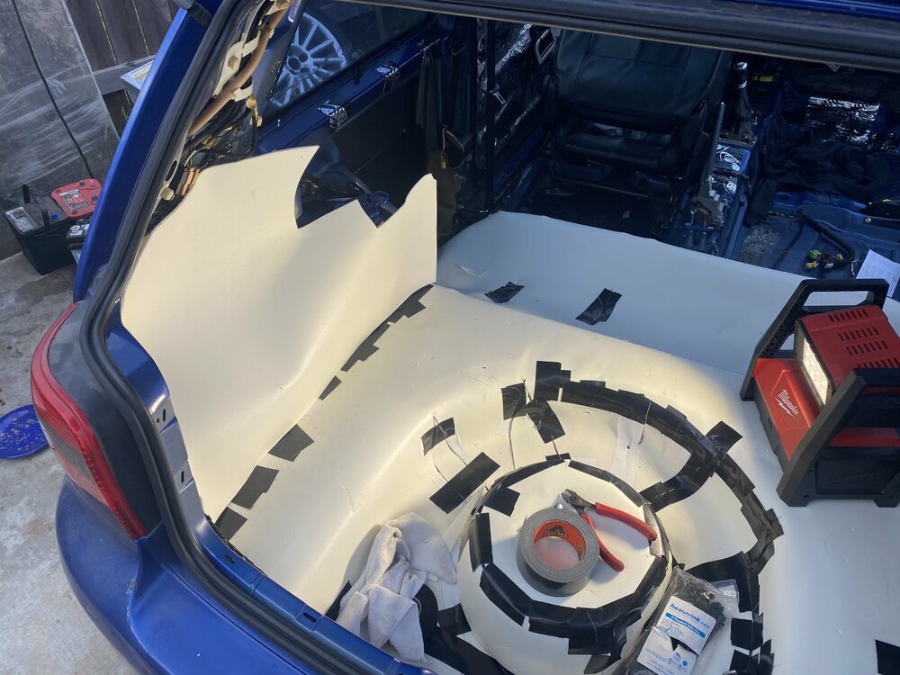

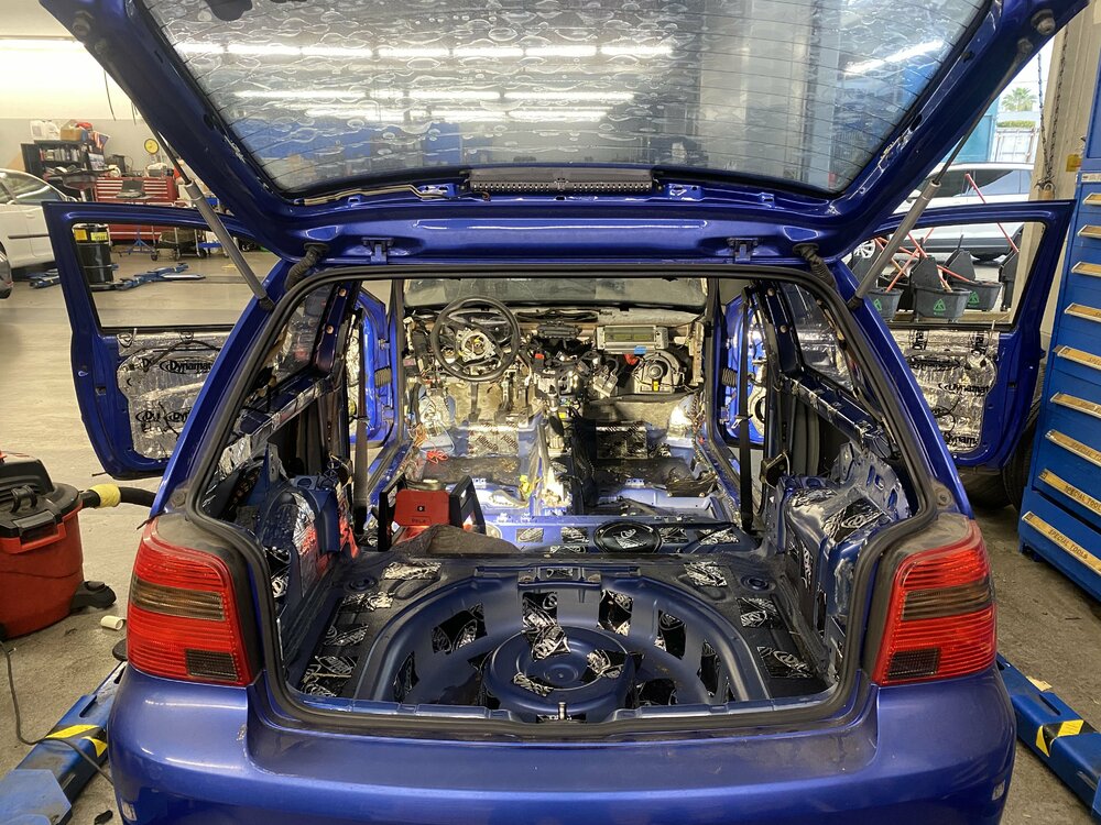

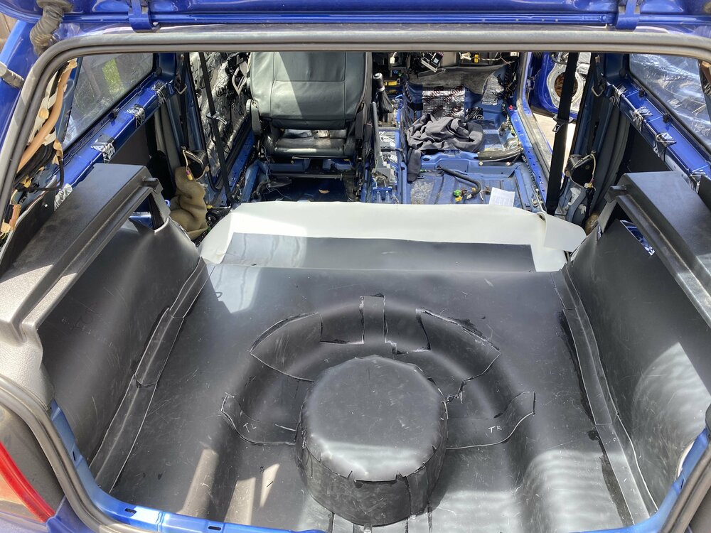

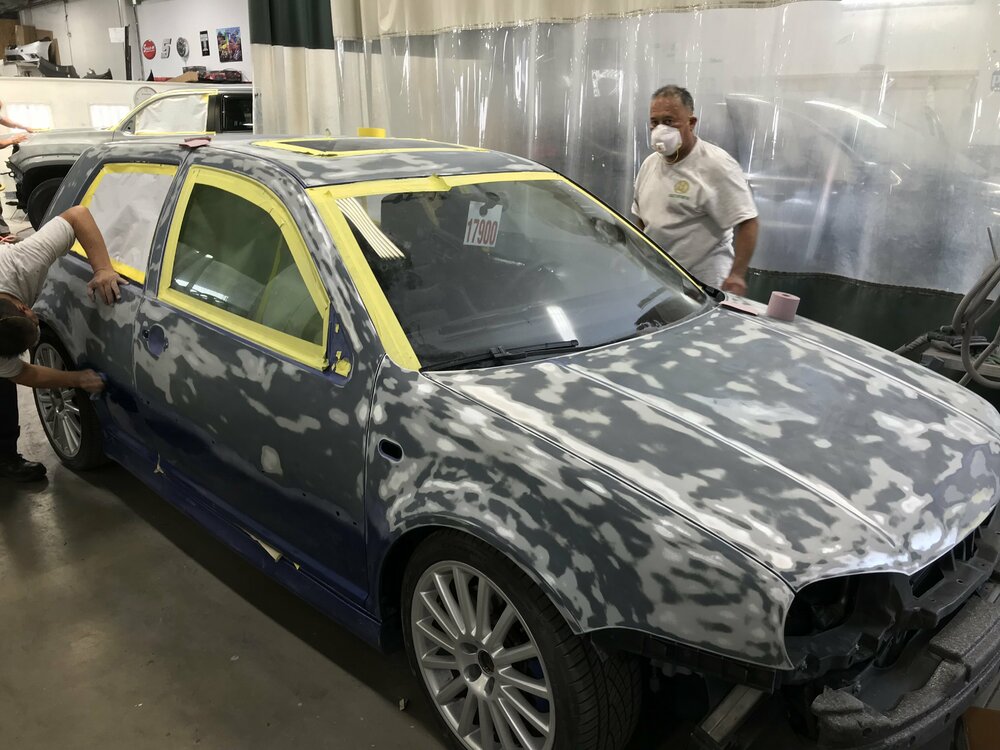

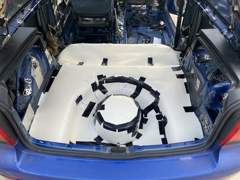

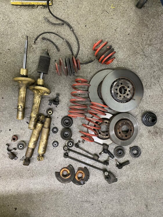

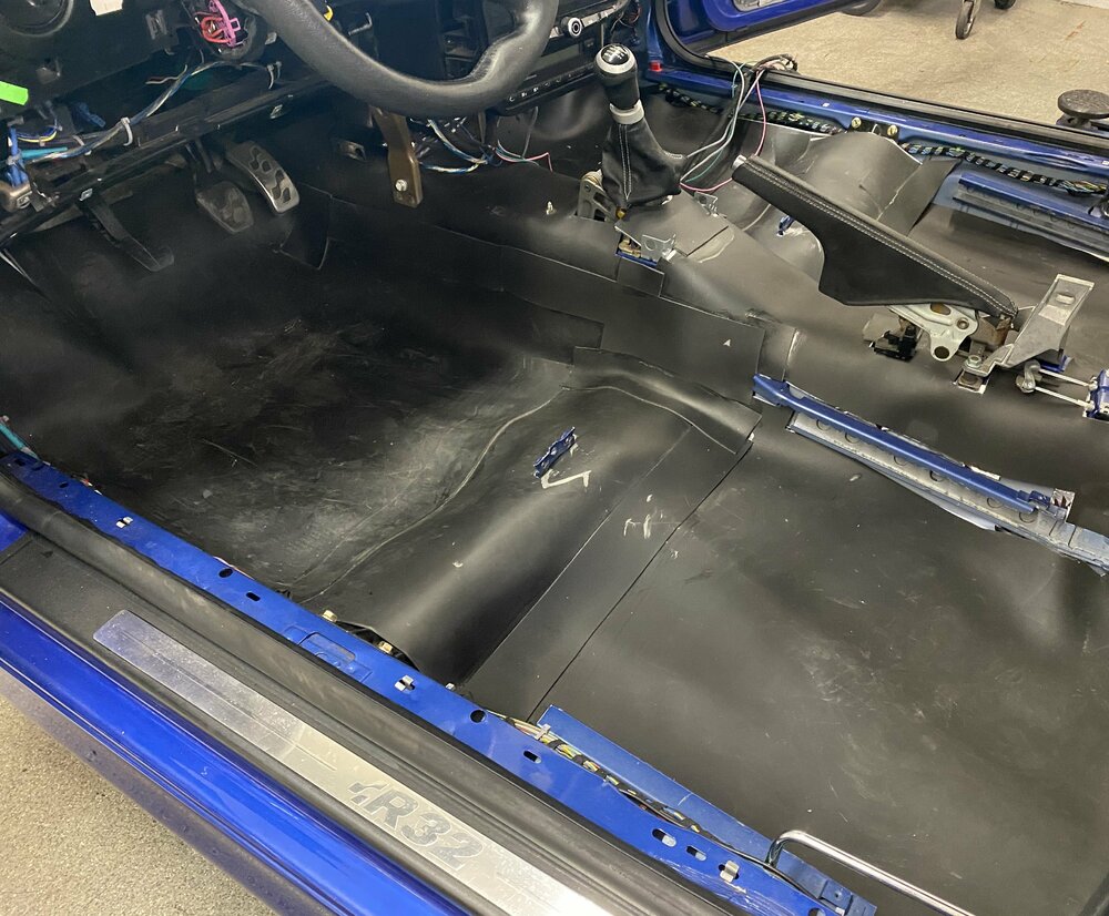

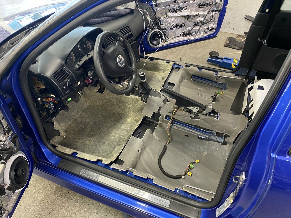

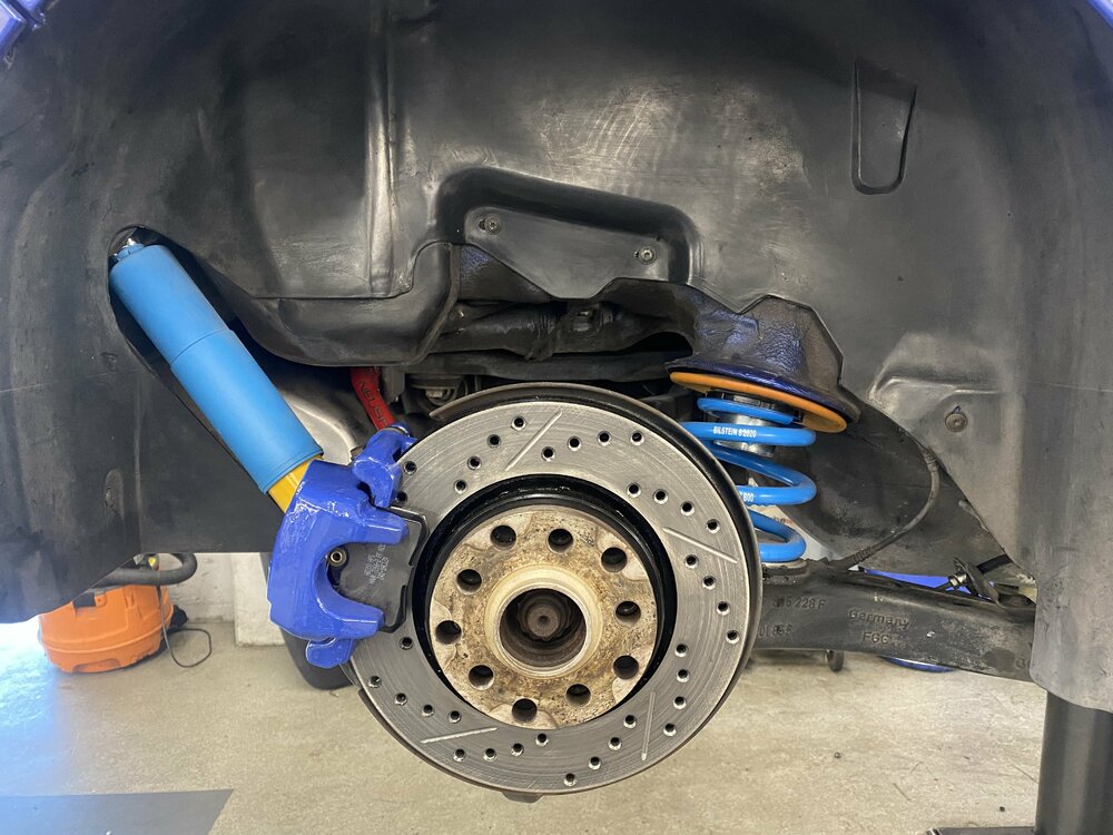

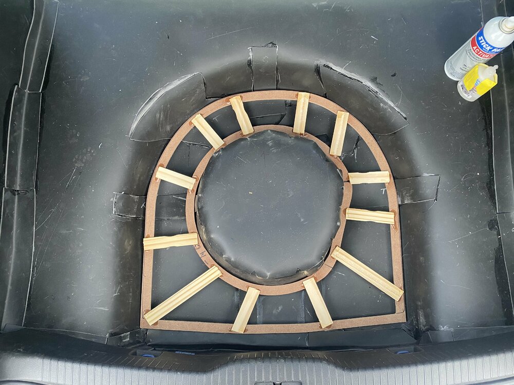

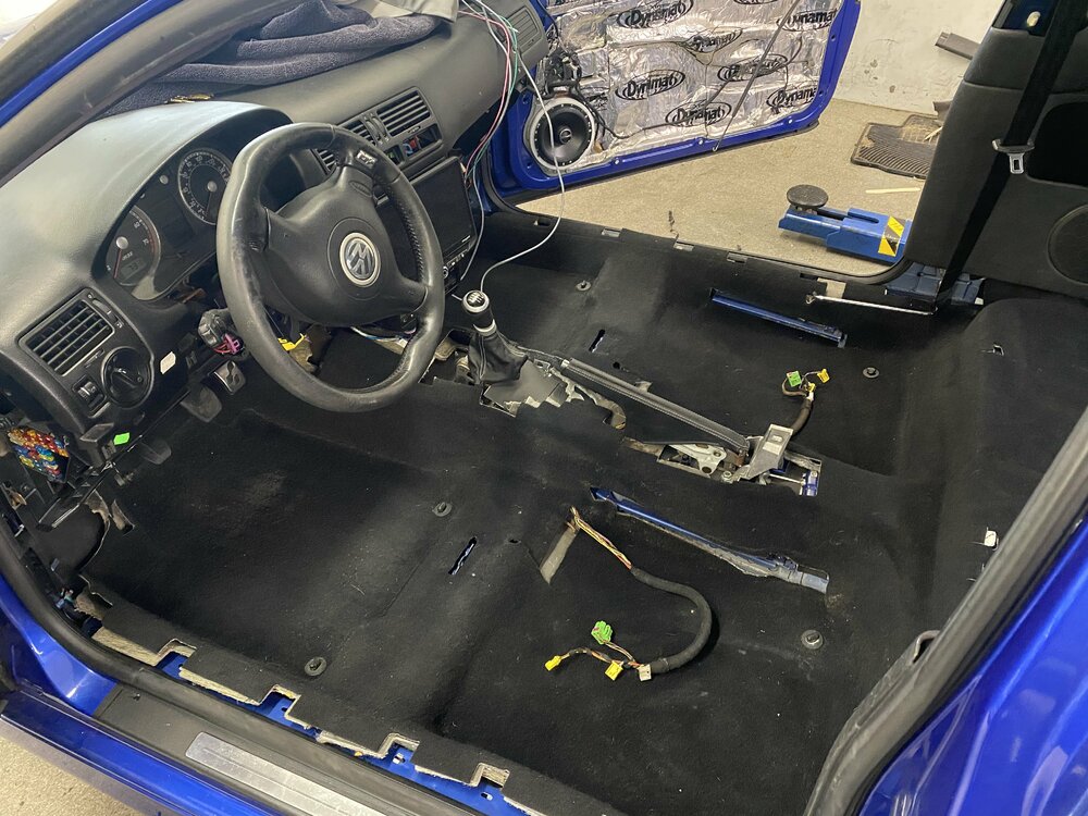

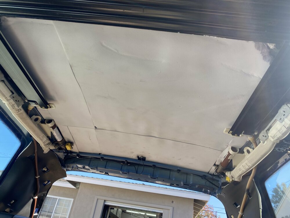

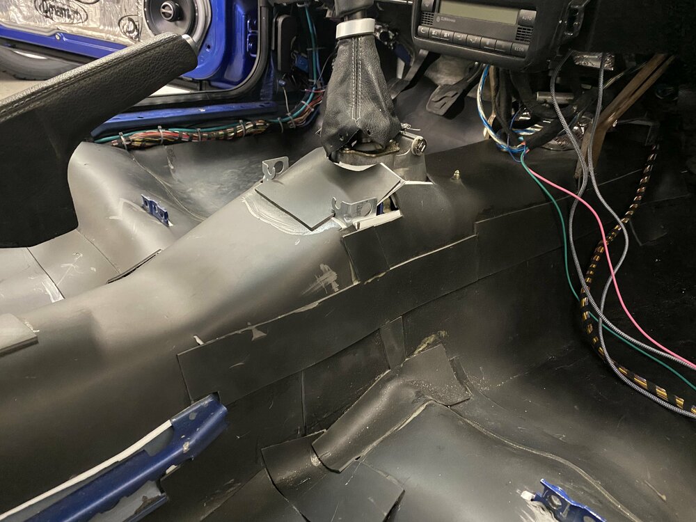

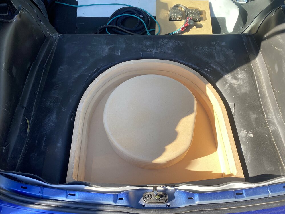

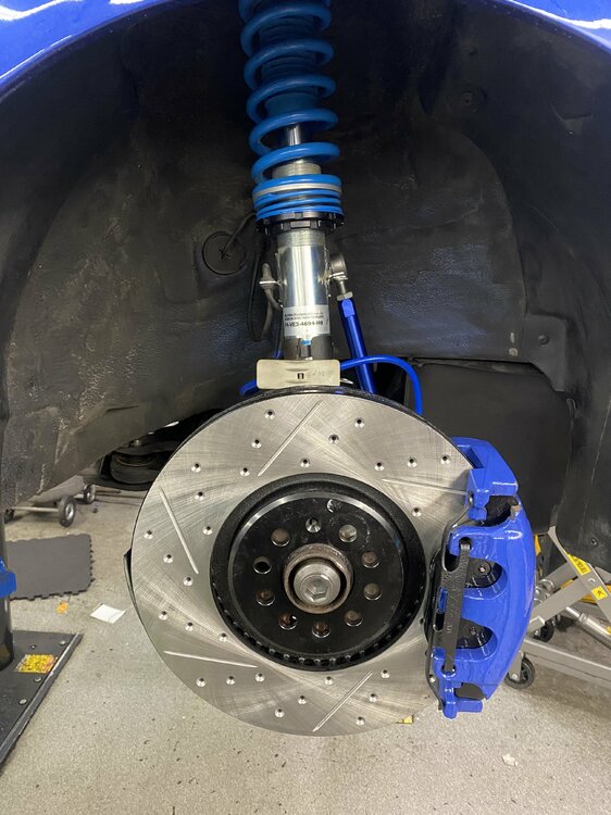

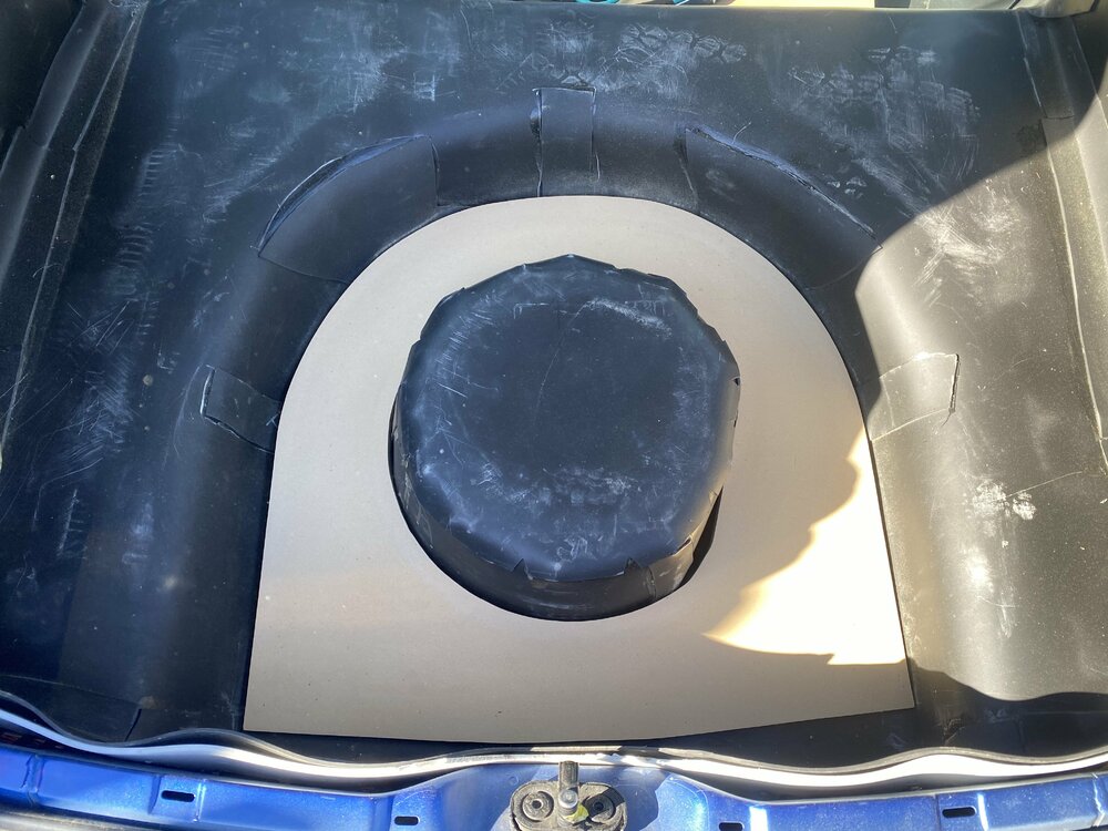

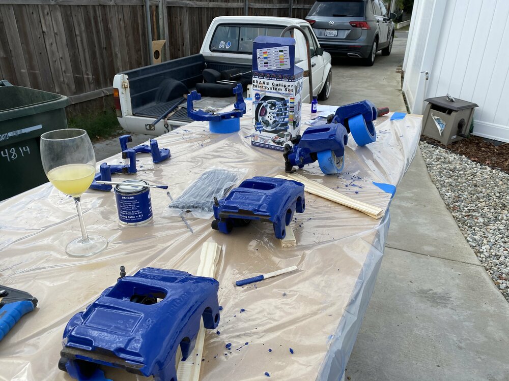

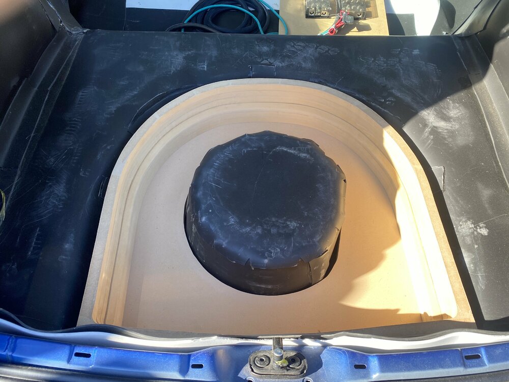

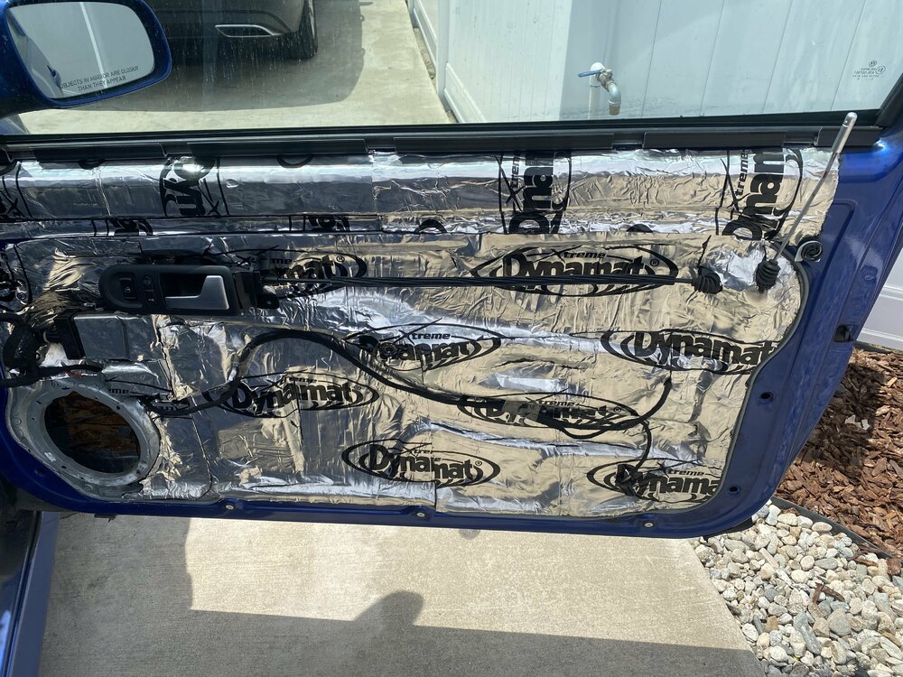

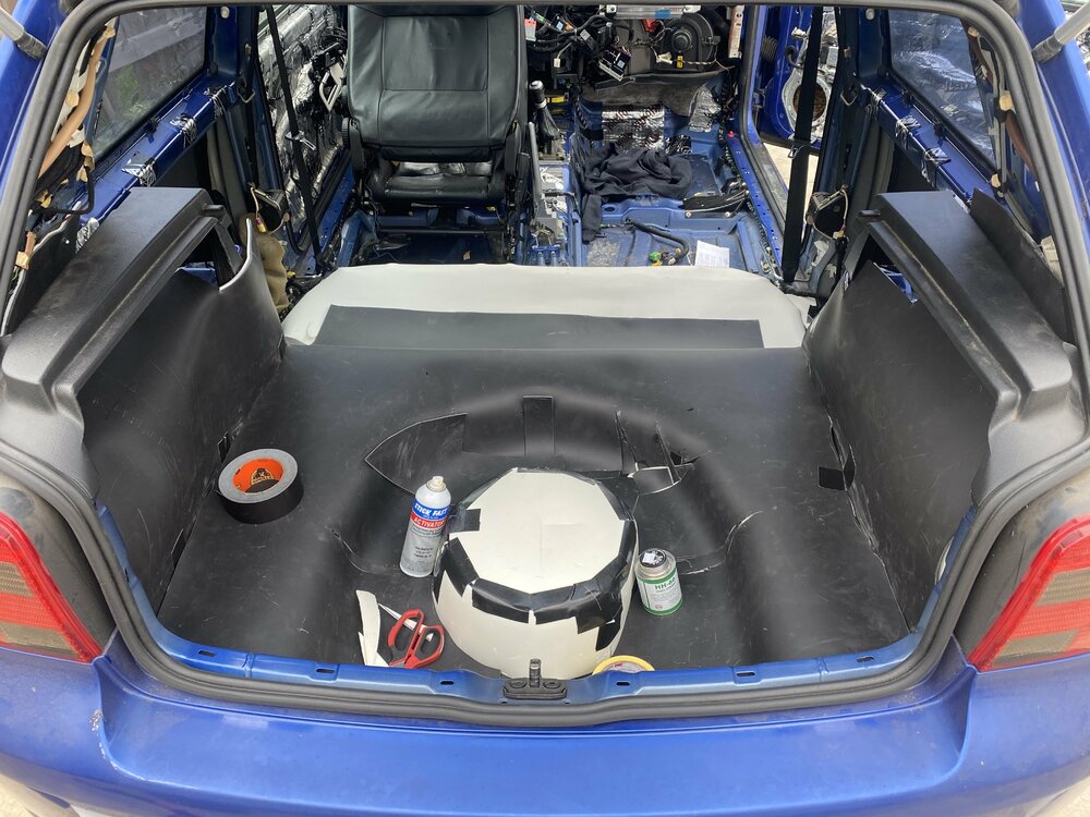

New system time for my R32 that I've owned since 2006. This time around I decided  to do a better sound deadening/proofing job.  CLD/CCF/MLV throughout and CLD/hydrophic melamine foam for the roof. I also did a full repaint and overhaul on the suspension/brake system
