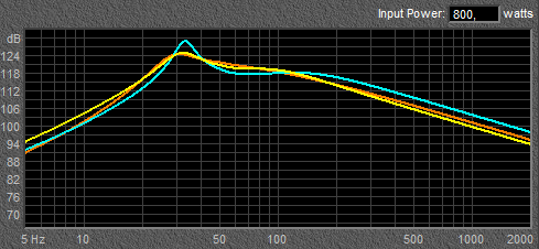

Here are the models for each sub you wanted:
Enclosure 2.25 net @ 33Hz, 800 WRMS:
dd612e (yellow)
xfire xfr 12  (blue)
Re sex 12" v2 (orange)
The DD and the RE model very similar in small signal, I would still prefer the RE for the lows.
The Xfire has higher power handling and very peaky, will probably be louder and you can later upgrade to a higher power amp. The thing though is that I don't really know Xfire, so you will have to research yourself if they are legit or not.
There many subs that can work on 800W and that box but I can't just go through them all so hopefully others join to give suggestions.
For the time being I would pick the RE for the lows.
dd612e (yellow)
xfire xfr 12  (blue)

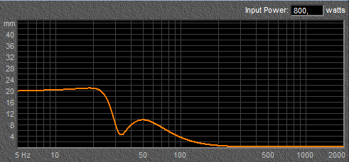

Vent airspeed:
Cone excursion:
You can see that on the box specs and power being used, operating conditions are within limits.

You can use that box if the specs are as stated,
Vent airspeed:
Cone excursion:

Assuming a single layer baffle and 0.75 wood your box is 2.246 @ 33.7Hz with port area of 39 square inches, the driver displacement of the RE SEX 12 is 0.15 cubic feet, previous specs are with the driver installed.
Looks pretty in line with the curves above and a decent alignment to try, power should be fine. Group delay peaks at 28 msec so pretty decent too.
