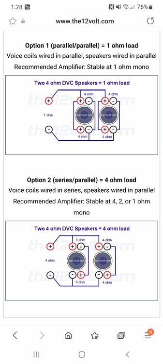

That amplifier won't play below 1.3 ohms unfortunately, so with dual 4 ohm subs, you can only wire them to 8 ohm so the amplifier will see a final 4 ohm impedance

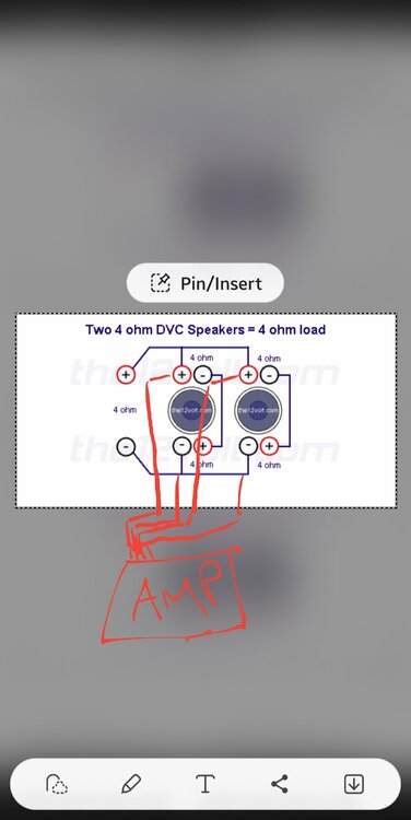

I wired them as you recommended @ 4ohm after reading the jl 1000/1 manual it says it has 2 speaker wiring  terminals to help with wiring but essentially it's a 1 channel amp so am I right in thinking this:
plug 1 MINUS to the other coils PLUS and the remaining plus & minus plug to the box terminals and the to the amp on 1 speaker terminal and same for the other sub onto the remaining terminal
13 hours ago, Jay1182 said:
I wired them as you recommended but it wasn't hitting hard at all at 4ohm so then I researched further then a mate recommended something else
so  wired a single coil from each sub into the jl1000/1 it drops so much better than 4ohm Thank you
So what do you make of getting better results from wiring to 2 ohm instead of 4 a constant power (1.5-4 ohm) amplifier?
Counterfeit amp maybe?
