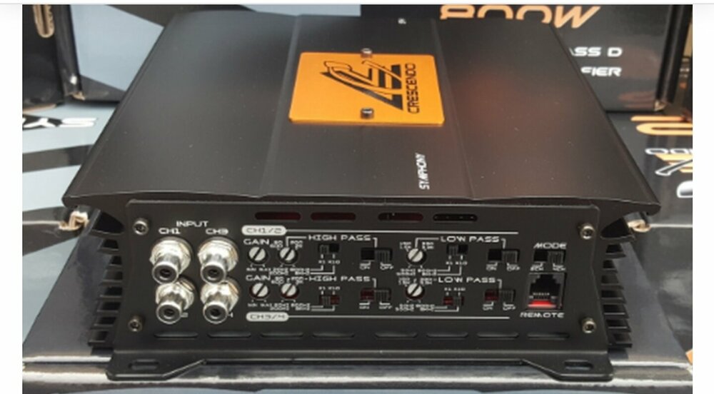

If you get a 4 channel amplifier that is capable of bandpass crossovers, you don't need a DSP. Such as a Cresendo S4 1822674461_Screenshot_20211224-165755_SamsungInternet.thumb.jpg.cf4ff3f23929f4906290b442ce241917.jpgdo you see how you can set a HPF and a LPF for the same channel?
Also how you can set the crossovers for channels 1 & 2, then a different set of crossovers for channels 3 & 4? You can wire a set of 6.5's together for channel 1, then the other 2 for channel 2. Then you can use the other 2 channels for the tweeters.
You don't need to use the S4 specifically, just an amplifier that's capable of what I just explained.
