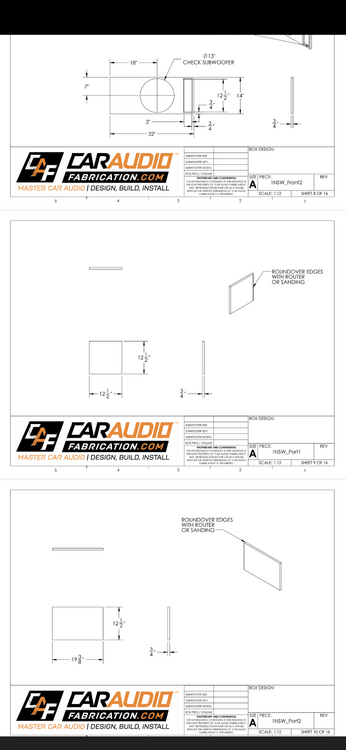

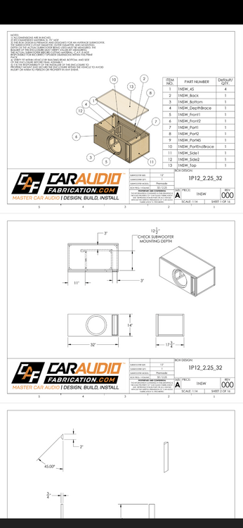

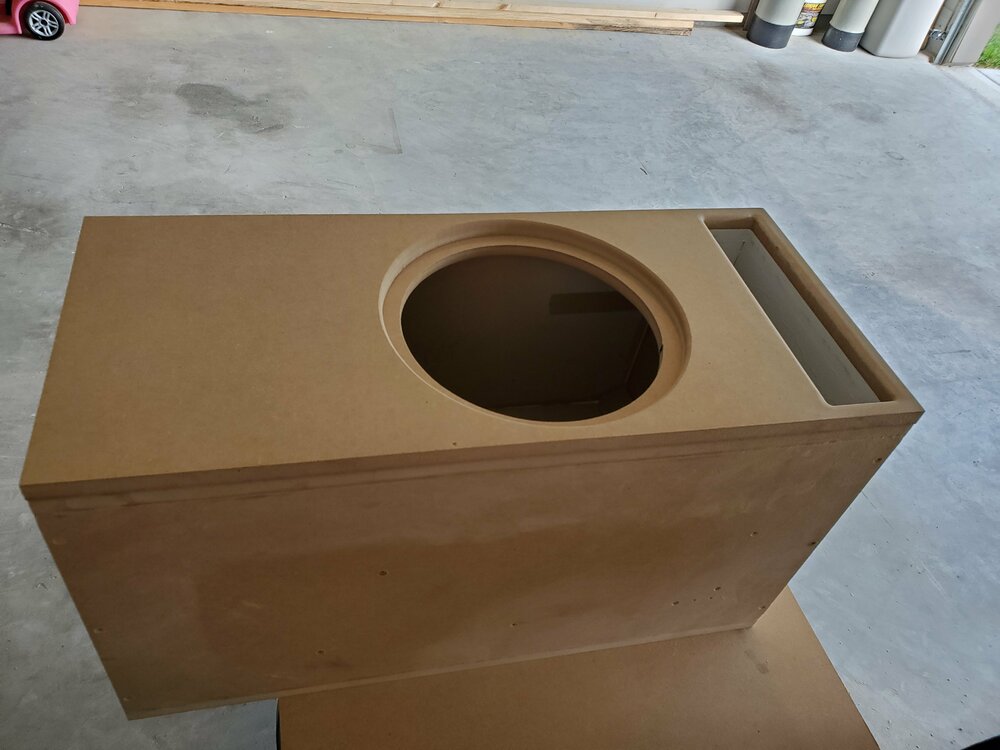

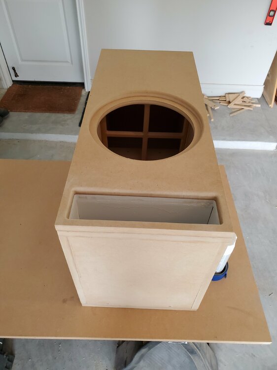

Nineteen69mach1 Posted January 4, 2022 Author Report Posted January 4, 2022 First pic is the box size and the second pic is the dimensions of the port walls

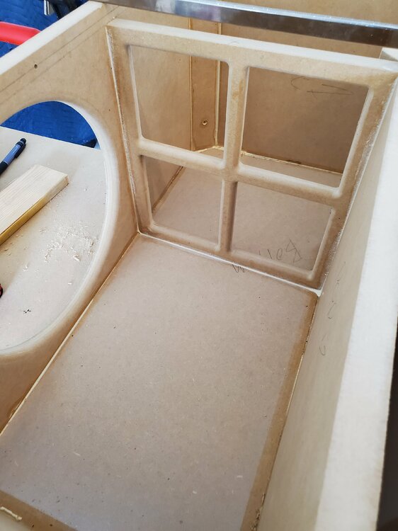

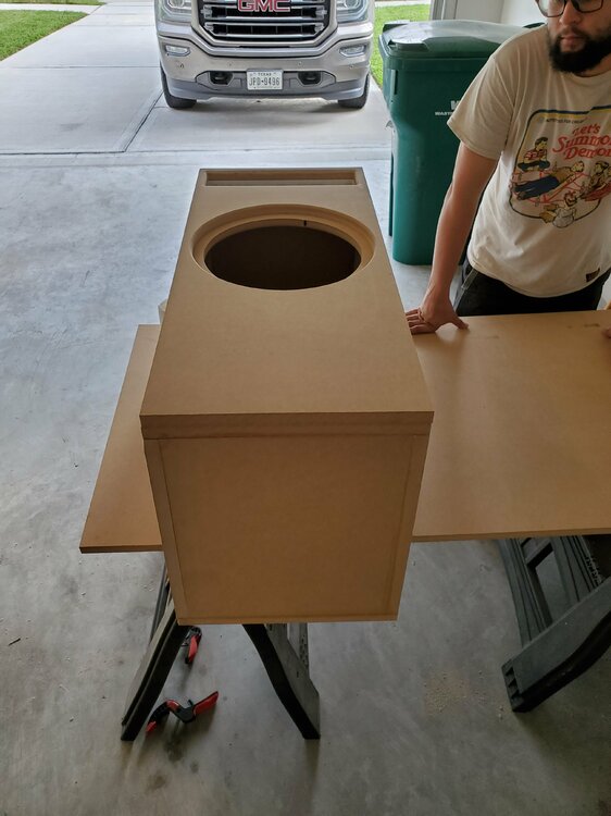

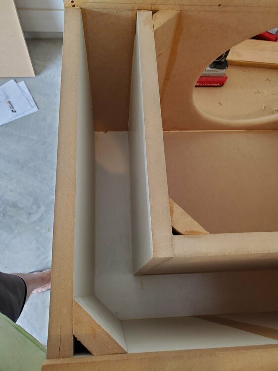

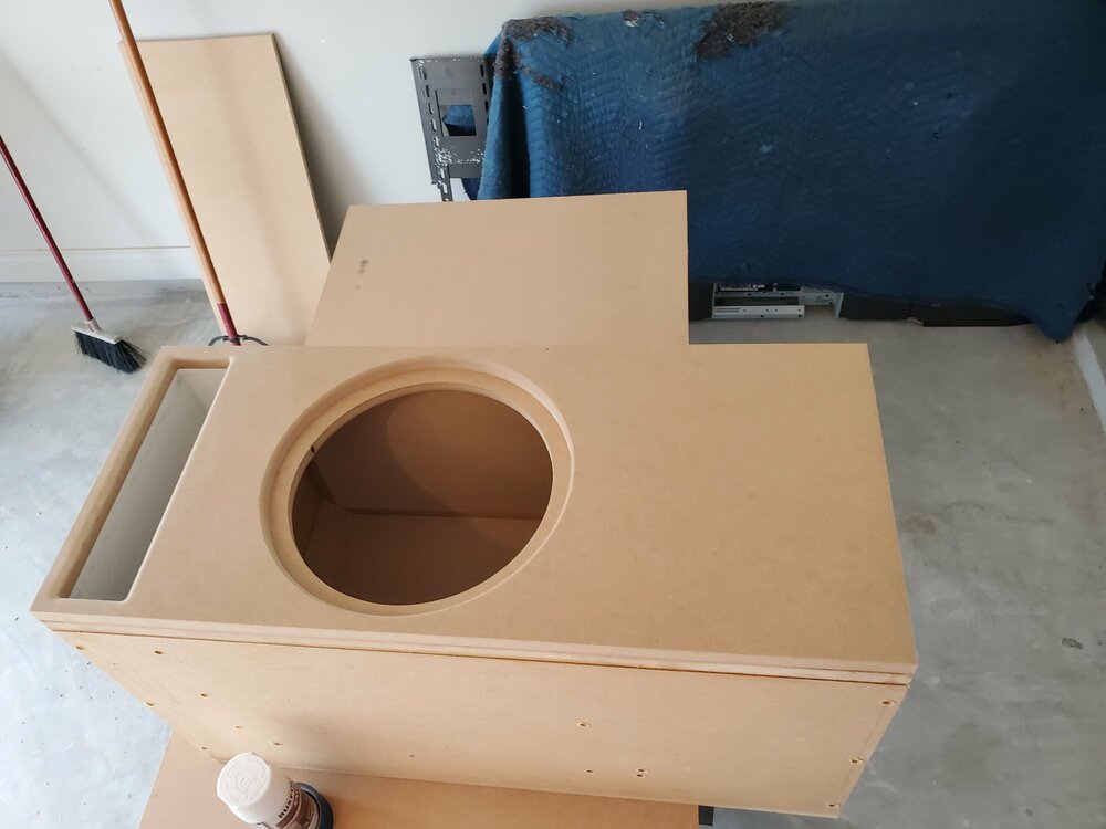

Nineteen69mach1 Posted January 4, 2022 Author Report Posted January 4, 2022 Dont mind the round hole LOL. It's square now.

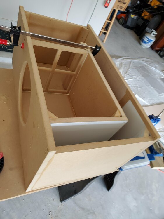

Joe X Posted January 4, 2022 Report Posted January 4, 2022 The enclosure specs check out basically, small difference is due to the driver displacement of different drivers. Port area 37.5 sqin. You know you could have a leak after the messy job of changing the driver hole from round to square, do you have a picture or pictures of that?
