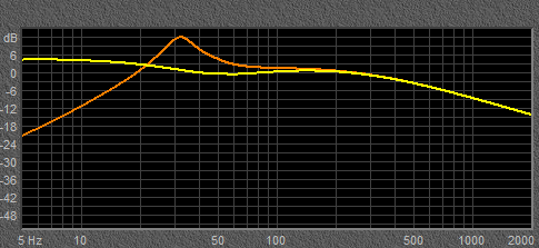

Here's what modeling shows for your sub between a 1.5 cuft sealed (yellow plot) and a 2 cuft @ 32 Hz enclosure (orange plot):
It's a lot of output lost using sealed in this case.
Damn, I knew sealed wasn't as loud but that's a pretty big difference. I appreciate you showing me that! You live and you learn!! I think this will be my last sealed box lol. But that's okay, just happy to be learning some new things!!
