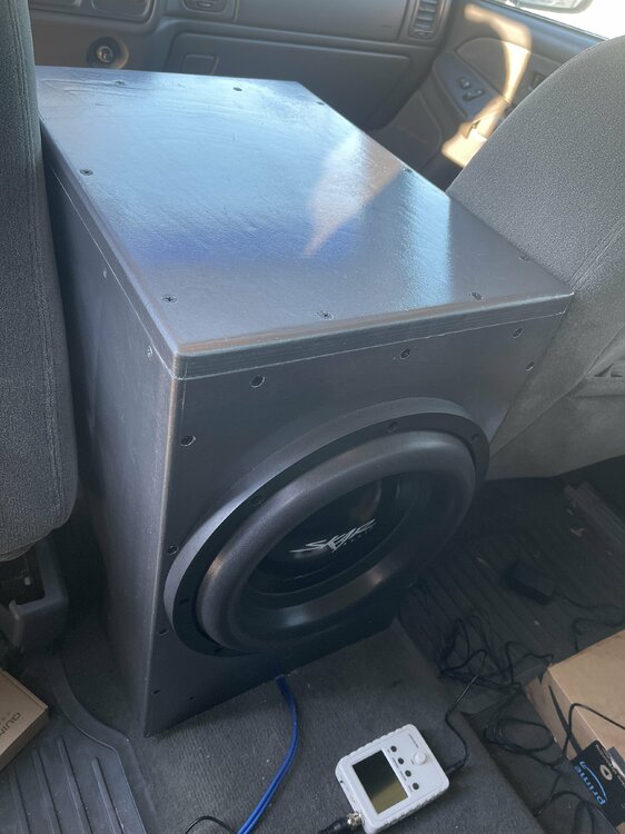

Hey guys, recently got my small sub setup put in. Its a Skar EVL 12 with a Skar RP1500D AMP. Box is close to 1.5 cubes sealed. I got an oscilloscope and tuned gain for clipping. No bass boost is on the amp or the HU. And i feel extremely underwhelmed. The sub is in an open cab truck and I feel like it should be hitting much harder than it is. The only thing i was thinking it could be is I have the Sony XAV AX3000 head unit. The back end only has 1 "sub" RCA port. So I ran the other rca into a "rear" port on the head unit. Do you think this is the problem or is the sub and amp combo kind of just meh? It was more of a budget build I'm just feeling like it should be putting out much more. Anything helps. Here's a pic for reference.

Open cab truck? Probably that alone is the reason as you have no cabin gain, then you are using an undersized sealed box, ported should be used, down firing designs help sometimes in such conditions. more pictures of the vehicle would better help see your situation.

I'm aware the box is a bit small for what is recommended. Ran into a could hiccups when building so that's what I had to run with. The truck is an 03 Silverado extended cab. I took out the Center console and built a center console and built the box inside. The sub fires facing the rear. The biggest problems is when i set the gain using an O scope. I use a 40 htz test tone and its loud!! Maybe even a little too loud for me. But then when I go and play a couple bass heavy songs its just meh. I feel like something is wrong with my tuning maybe? My biggest worry is to the blow the sub. I love bass and I'm a college student. I can only afford so much. I just don't get when it slams while tuning and then switch to a song and its not even close to what it was.

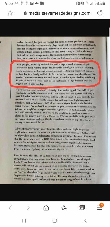

In the mean time, try setting your gain with a -5 db 40 hz test tone. Yes, a specific, 0 db test tone is going to be focused on that one particular tone and be louder than music. Music is typically recorded at a -10 db.
Here's a little excerpt from a book I like to post about using overlap when setting up your gains. I think it explains it quite well. Yes, i stole it from an older post from this forum 🤣1087261443_Screenshot_20201103-215547_SamsungInternet.thumb.jpg.a86df385b8ef2b23a82cf7bc0074d186.jpg
