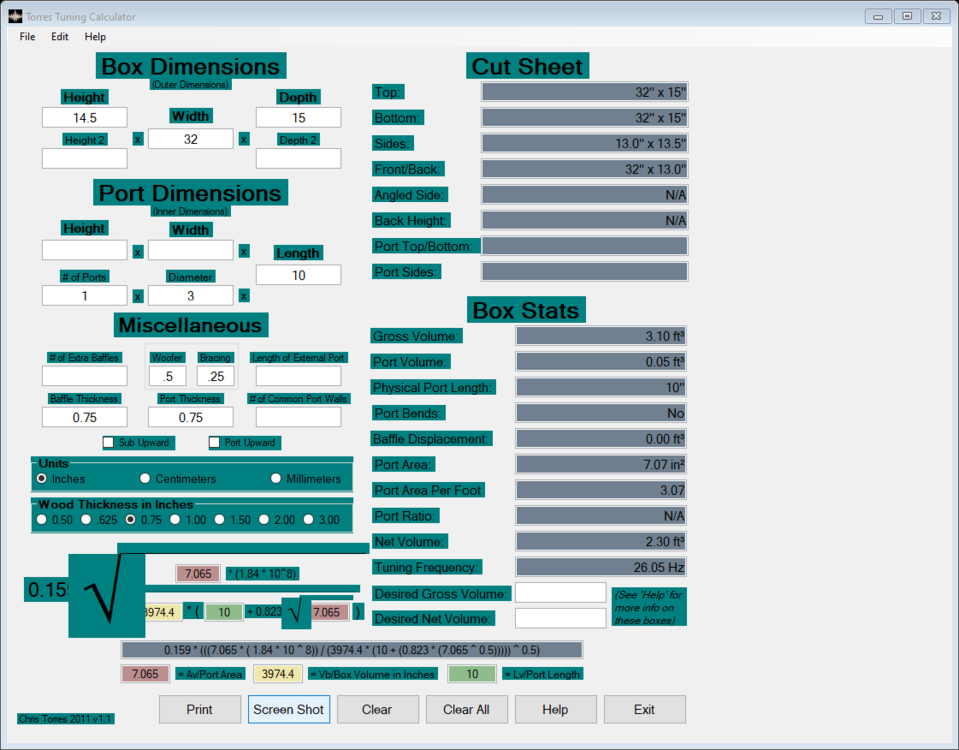

bsneon98 Posted May 1, 2022 Report Posted May 1, 2022 Hey guys, been a minute since ive done anything serious audio related. I Have a box to build for a zvx8 going into a 1gn TSX. Have never built anything with aeros so have no idea what to expect but seems to be the best way with space constraints. The end goal is to have a decent bandwidth but im not sure if its tuned too low to do highs and lows. Do these box specs look ok? Thanks in advance! Build Log: http://www.stevemeadedesigns.com/board/topic/152954-1998-plymouth-neon-updates/
Joe X Posted May 1, 2022 Report Posted May 1, 2022 ZVX-8 is this: https://www.skaraudio.com/products/zvx-8-inch-car-subwoofer 1.25 net and like 14 square inches of port area.
