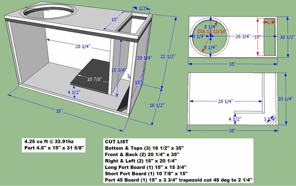

Ok so your dimensions are insufficient for the stock spec you show above so I took a little depth and height keeping the original spec as close as possible, let me know in case the following external dimensions will not work for you.
Here is an even tighter spec but net volume takes a 0.25 net hit:
