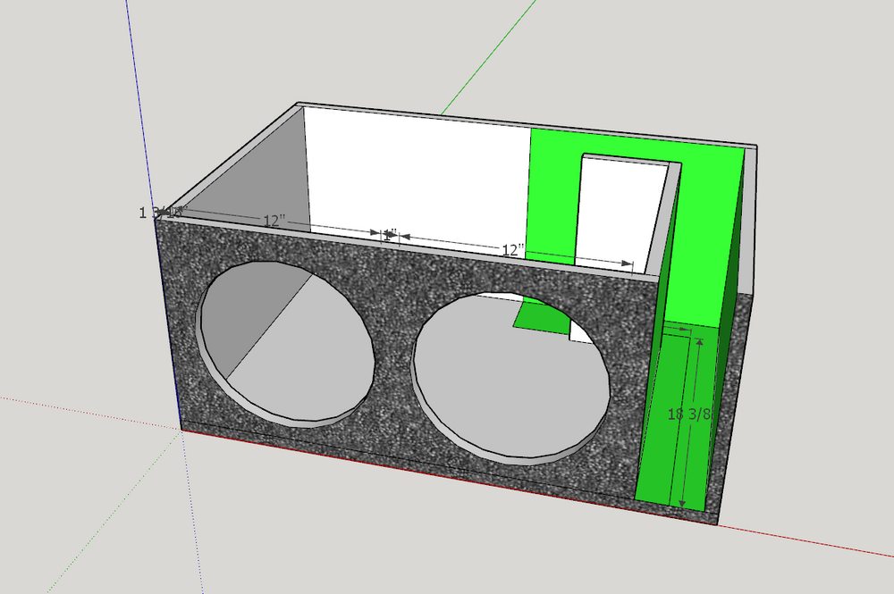

The port length is measured along the center line, not adding the port walls lengths. Your port 2 part needs to be like 4" so that the center line length is 26.
So, if I’m using Torres when it says psychical port length which is dif then the number I put in the box to come up with my tuning and would be the actual wood length from inside the box against the L correct? So I would take my 26 inches and go straight thru the middle of the port to the opening of the port? My question is how would I calculate my port parts since torres doesn’t give u the cut sheet for ports? Since in this case it seems it would be shorter the those 2 cut sheet specs I came up with.. sorry hope you understand what I’m saying.
You have sketchup, just draw the center line that is 26 long and then it becomes obvious the length of the L2 part.
Updated this should be in then, Thanks so much for clearing that up for me! you all are awesome!
