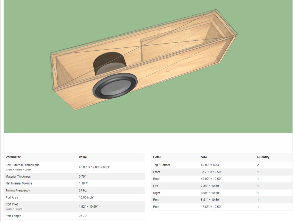

Hello,
I'm looking for a subwoofer design.
2015 Grand Cherokee w/ Harmon Kardon system.
Stock head unit, Audio Control LC2i, NVX XAD12 (rated 1500w @ 1 ohm, 1/0 OFC KnuKnoceptz, stock electrical.
SA U10-D2
Mostly rap music, some R&B and old rock.
I'll be building it myself. 3/4" MDF. Double baffle. Sub/port facing back.
The only firm dimension is the length of the enclosure - 40". I'd like the width to be as small as possible (as to leave as much cargo space as possible), and the max height is 16".
Below is what I came up with, but there doesn't seem to be enough space behind the sub.
Learning Everyday.
