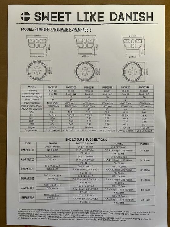

Pic straight from the B2's facebook page:
So I would try to talk to someone who makes sense over there because I got a manual supposedly for those drivers that says do 17.6 square inches per driver, what a mess they have going.
I don't think they even have that driver on their website. They have a Rampage 15 but comparing the #'s to sky high doesn't add up. The B2 PDF says .49 displacement which matches what the v3 is, not the v4 that he bought.
Subs should have their manuals with correct parameters inside the box but no way a single 8" port is going to do the job, it will need to be like the pictured box I posted above.
that's what I was needing to know. Would you know how long each port would need to be for a ~30hz tune in a shared 8.4 cu ft box? I'll figure out the port displacement then make the enclosure that much larger to net 8.4. It's going to be a standard rectangle enclosure so that part will be easy. I'm thinking they'll need to be a little too long but want to make sure first. I think I'll probably have to go with a slot port, which is fine but we were liking the idea of trying the aeros.
Also, I figured the specs would be on the site. They were (of course lol) in the box and they do match the ones I assumed were right on Sky High's site. B2 needs to update theirs.
Is what I read wrong about aeros needing nearly half the port area? A single 8" gives 50.2 of the 86.6 the specs call for, which is around 58%. I've read an aero only needs 56% of the area, is that not true? I trust what you say 100% & appreciate your responses. I've never done a dual port design. I'm showing my length as needing to be ~31" w/flare per port if I did 2, which won't give the needed port clearance inside the box. That's how it works right, when adding the additional port, the number I'm getting on the length calculator is per port so I think I'm back to a slot design if that's the case.
The parameters are the same as listed in the skyhigh page, minimal set of parameters that let you figure port area but not enough to figure cone excursion or motor strength. With those parameters, 9K, two subs, 8.4 net and a single 8" port that port get airspeeds above 70 m/s, you could get away with 35 m/s with round ports but nothing like 70s. Again talk to someone who is actually running those subs and get some opinions.
