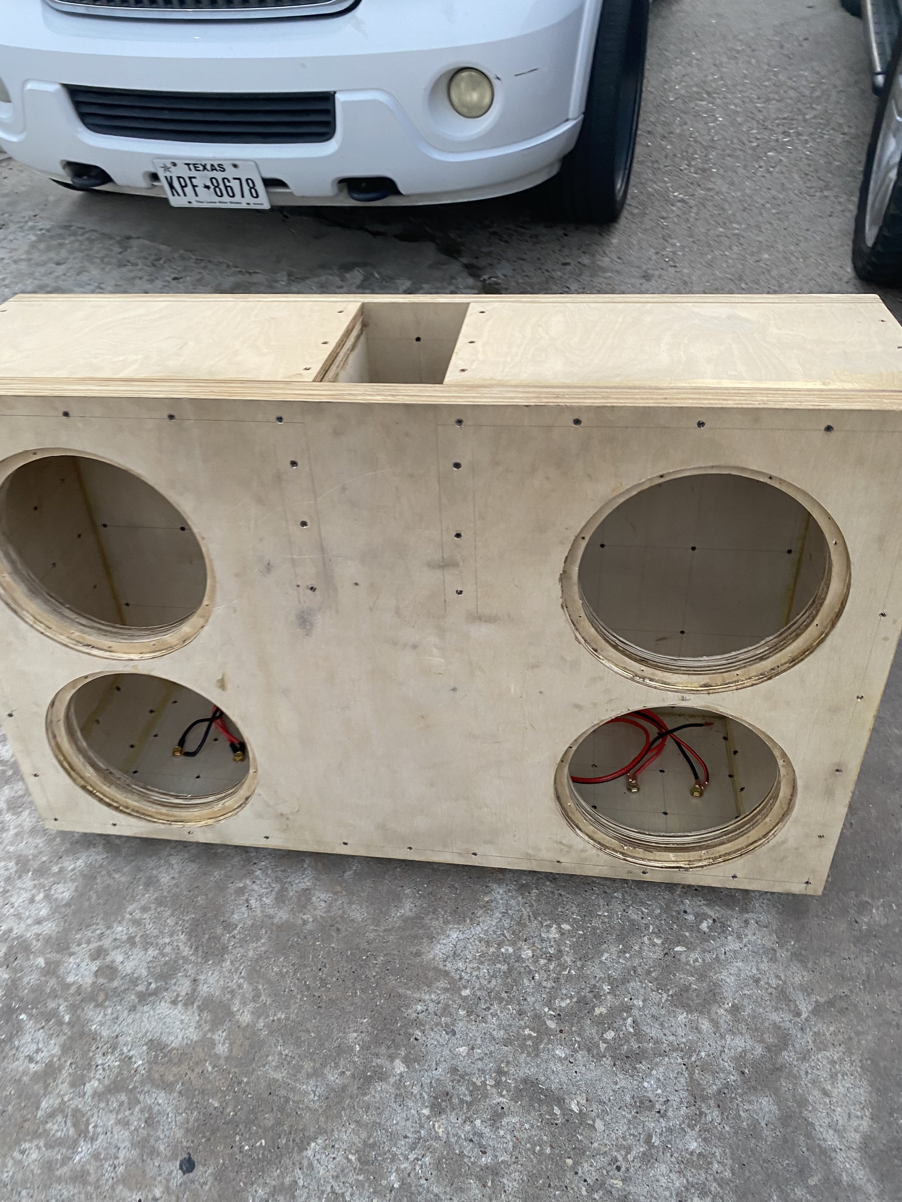

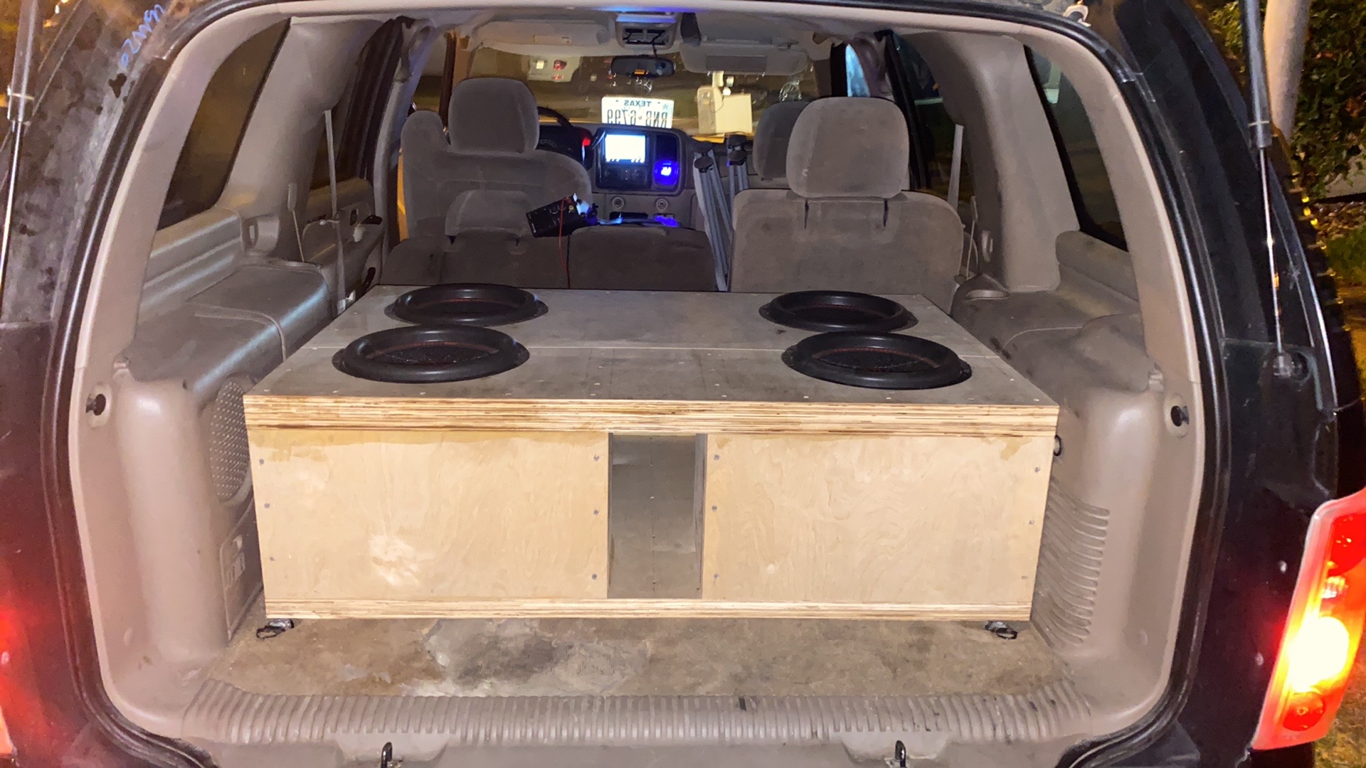

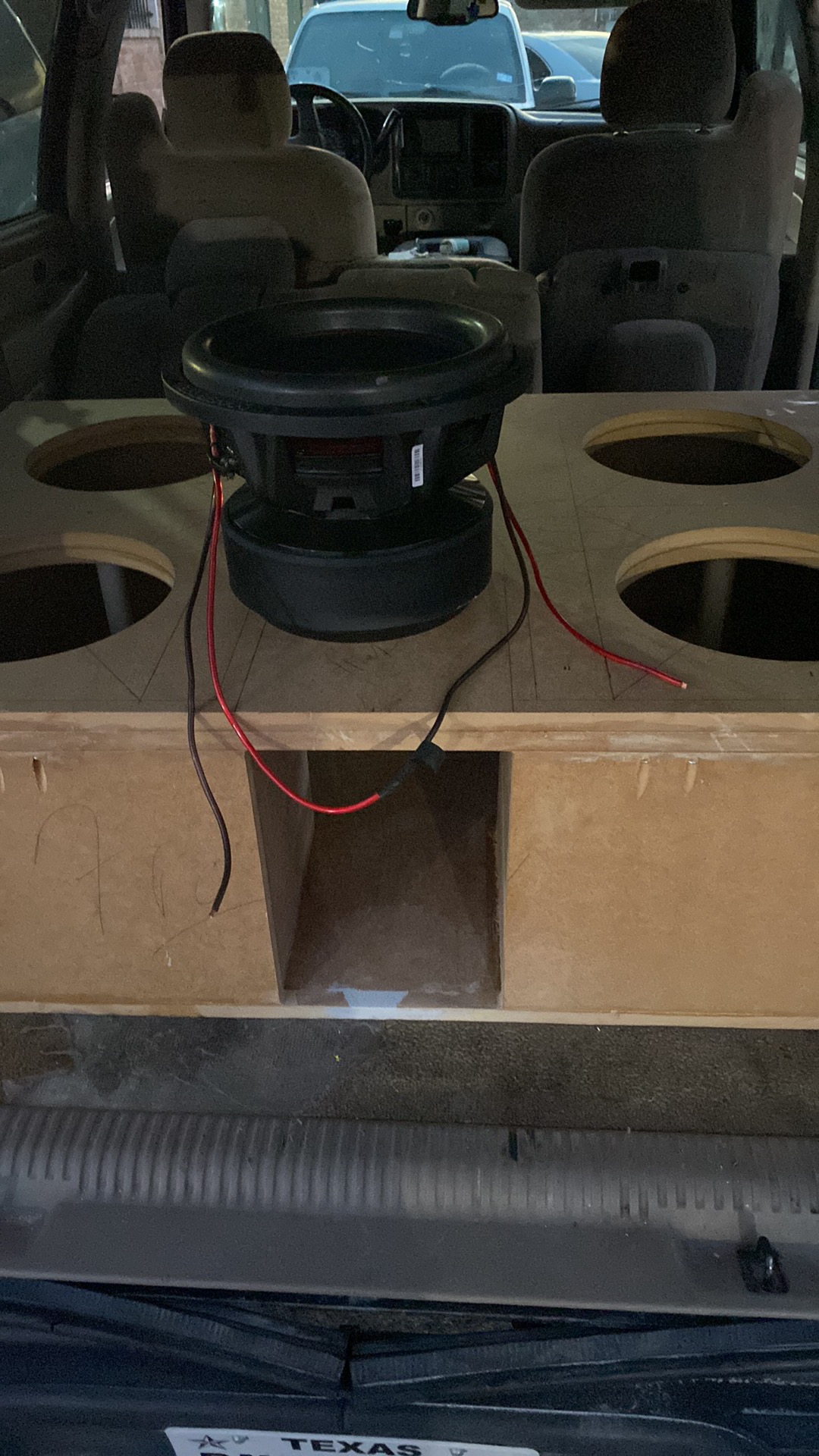

Joshua4201splguy Posted September 13, 2022 Report Posted September 13, 2022 Hello I am trying to build a burp box for my 03 Tahoe for my 4 12inch hippo xlr’s I have them being pushed by a ds18 hooligan 8k at one ohm which I’m getting 5996 out with consistency battery is a 45ah cmax alternator is a mechman 400 with a voltage of 15.2 running in stock class in usaci. the first two boxes I had were about 2sq foot per sub which is to spec of the sub one box birch double layers with triple on top depth 30 inches width 48 inches hight 14 inches 45’s in all corners port was 5 7/8inches wide by 10 inches deep 12 inches hight peak 47-51hz 152.93db the second box mdf single layer with double on top 48 width 33 depth 14 hight 45’s in weak areas port was 10inches by 10 inches same 12 inch hight peak 52 hz 153.1. trying to find out how to add db’s without adding power just by changing the box. I’ve had more power but was only able to achieve 154.64db out of both boxes. any suggestions

Joshua4201splguy Posted September 14, 2022 Author Report Posted September 14, 2022 So the first two pics are the first box I was using and the third pic is the new box
Joe X Posted September 14, 2022 Report Posted September 14, 2022 Those boxes look solidly built but you are going to want VARIABLE tuning port, not fixed frequency. If you don't have a term lab you can get the SSA APM-2 SPL meter which is good to 174 dB it's considerably less expensive than the termlab. Your subs are good for the application but I can't tell you if your boxes are any good without some basic measurements, port area though seem too low in both boxes, just for that you may be having significant dB losses.
Joshua4201splguy Posted September 14, 2022 Author Report Posted September 14, 2022 What do you mean by port area is to low do I need to widen it or make it deeper?
Joe X Posted September 15, 2022 Report Posted September 15, 2022 In your case port area is height x width of the port, if you are not familiar with box design concepts and you don't have tools like the SPL meter and others, probably you should have someone to do the job for you.
