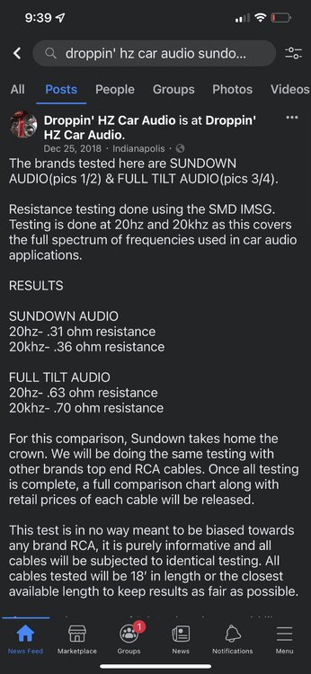

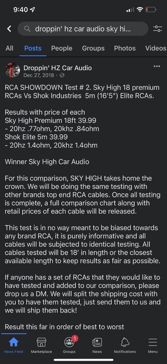

Just curious how important the results from testing the resistance like this truly is. Looking for a good set . The two I’m looking at is in this test but should I base on this test?

I tested a new 1.5 foot Certified Bassheads rca cable at 0.12 ohms against some well used 3 foot SMD rca cables that came in at 0.05 ohms, vs a well used 6 foot SMD rca cables 0.09 ohms.
Longer wire typically means more potential for voltage drop but the 6 foot SMD cables that came in lower than the CB cables that were 4 times shorter was rather interesting.
I have some longer 18 foot SMD cables that only read some where around 0.18 ohms iirc as well.
Not only will the wire length and gauge be a factor in the results, but the type solder being used to connect the ends to the wire (ideally silver solder), and the actual rca plugs being used as well.
