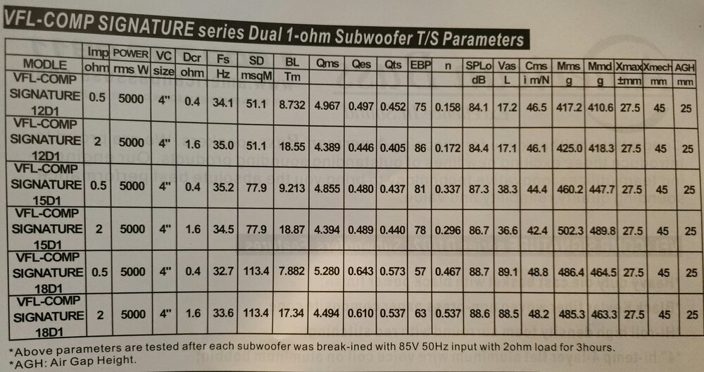

Yes those are the ones. I was told to use the Godfather specs as they are very similar...gotta love lack of information. I will look around in the book, but if it's anything like the xmax the book is a waste and doesn't provide any needed info.
All good. Apparently you have to own one to get the parameters lol should be as simple as scanning and uploading this sheet. Someone should create a repository of sub ts specs.

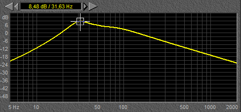

Here are the modeling results, as it turns out it's pretty nice driver for the lows working nice in the 5-6 cubic feet net, here are the plots for your intended power on 5 net per diver, 33hz and about 108 square inches of port area per driver:
At 5 net the projected response is well within the 28 -45 you wanted

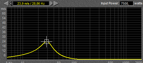

Vent airspeed acceptable at 108 square inches per driver.

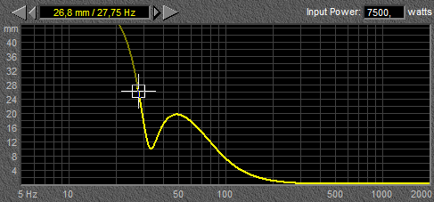

Cone excursion shows where to set your subsonic filter:
