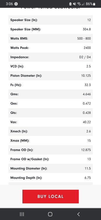

Hey guys, got me a dd 612e (parameters attached) and would really appreciate a custom box design. I know my way around building it.

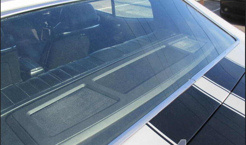

You don't usually remove your backseat rather do a custom rear deck, like this:
With the airspace open you can now use a ported box and it will work just fine.
