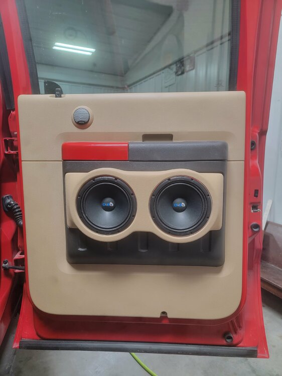

4 hours ago, 02Blazer said:
just a suggestion , wrap the rest of the black part of the door panel , leaving the black panel makes it look unfinished 👍

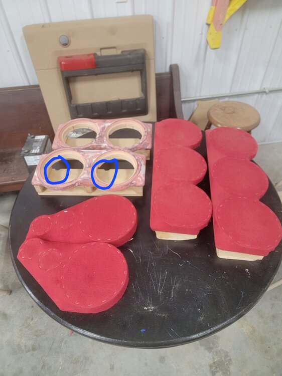

Not sure how I'd do that. I was trying to not have to cut the panels or jack them up incase I didn't like the outcome I could just leave stock. I think I decided to go with Tan r20230108_192728.thumb.jpg.42a274e9311cec22f0e78cd6c3241e84.jpgather then red tho I feel it blends better.
are the speaker baffles you made bolted /screwed to the door panel(black part )? can they be taken back off ??
Yes, they are removable. I built them without cutting any part of the door panel, if I decided to take them out there would just be some screw holes showing. I used 1/4-20 button head bolts with 1/4-20 wood inserts screwed into the back of the wood then used 1/8" flat bar to act as a big washer and screwed from the inside of the door panel into the speaker pod. If that makes sense. I have a cut out on the inside of the speaker pod to expose the factory bolts that hold the door panel to the door. So to take the door panel off I would have to remove the speakers basically.
take the pods off like that and wrap that black part or at least paint it to match the rest of the door  and then stand back and admire the difference !! you can thank me later , LOL !! 👍
