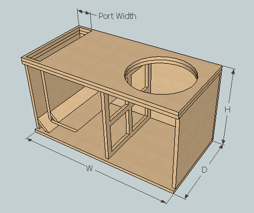

Joe X Posted January 26, 2023 Report Posted January 26, 2023 So here is a second suggestion, power: to sub rated, amp subsonic filter to 28Hz, minimum port clearance 9 cm, figure is just an assembly guide: NOTE: Tuning down to 34Hz and F3 of 26Hz, will be adequate for low tuned, music, net volume up to 4 cubic feet. NOTE: If building outside you need to build a cardboard dummy box to test fit in it's way inside.

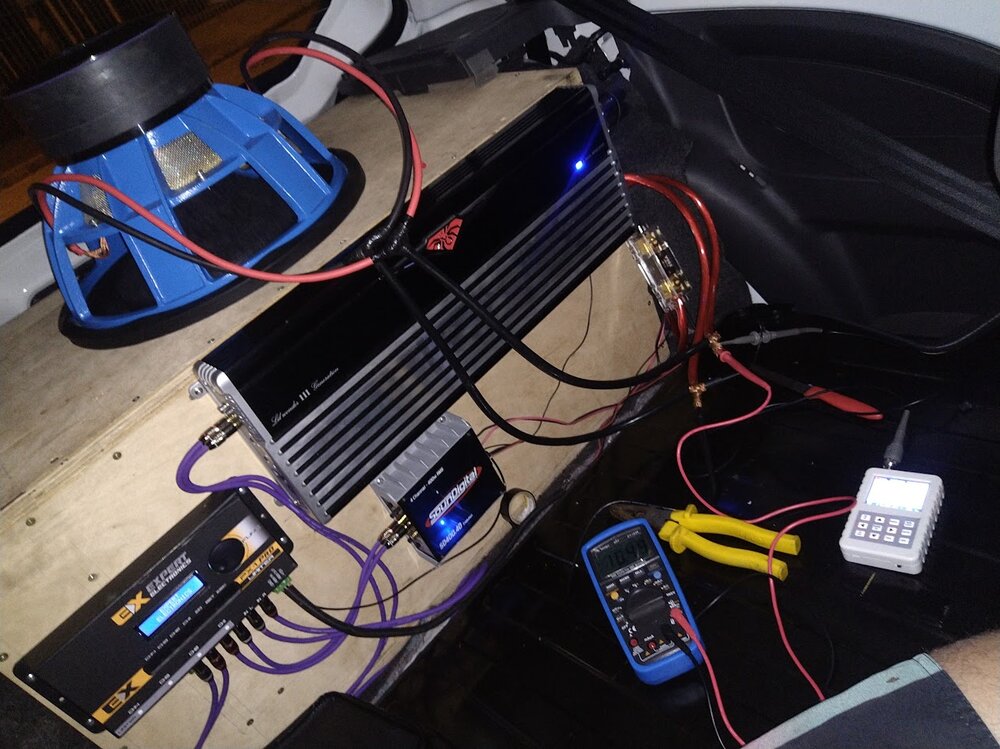

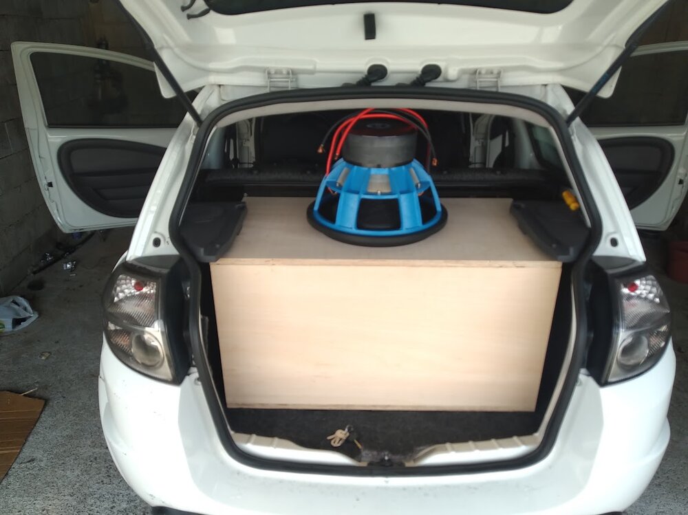

Joe X Posted February 3, 2023 Report Posted February 3, 2023 So I just wanted to see how is your system and I must say that your system is pretty nice and you do have a mulltimeter and a portable scope which should be enough for you to get it to work perfectly, the areas of concern that I see and may hurt your output are the following: 1) In the past system you show in the pics there seems to be no space for rear batteries so apparently you were running the system on the front battery only. 2) the enclosure you show there is no port visible and if there is a port on either side it wouldn't have enough clearance to work properly so yes a new ported enclosure should help you to get louder. 3) The stock alternator you mention of 60A could have a hard time recharging your batteries and could get damaged over time if you play your system loud for anything more than a few minutes a day and you would need to play your system a low level for a big while the alternator recharges your batts, you need to either get an aftermarket a high output alternator or use an external charger to keep your batts charged and help your current alternator from overworking . 4) Don't know if your amp actually puts out the claimed power, many soundstream amps put out much lower power than they claim, if so you could be losing output there. 5) Don't know of you went through a proper gain settings procedure BUT your DSP have an amplitude limiter function which should ensure that once it's setup you will not experience clipping as long as your head unit does not clip. Please read carefully the above points and seek to address the issues to get better performance in your current system.
